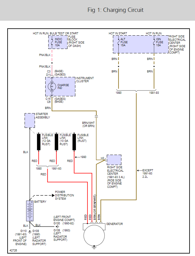

My volt light is on in my car. I have change the the alternator, starter, and the negative battery terminal. I got the battery check and it is fine. What is the problem?

This charging system has 2 fuses that must be checked here is an alternator wiring diagram to help you test for power.

Thanks for the wiring diagram, I found the alternator fuse was blown I wised I checked that first.
