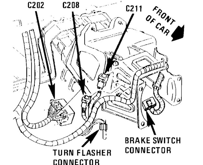

i have a bad turn signal flasher and i can't find it to replace. from what i've been told it supposed to be on the steering column but i can't find it. is there an alternate location? or is it hidden behind something?
Feb 15, 2009 at 8:40 AM
  • 75,992 POSTS
The turn signal flasher is located behind left side of dash right of the steering column
See the diagram attached below for location

ok, here's what i did. i went out and used turn signals without starting vehicle and listened for location of relay. drivers side uunder dash left of steering column obscured in a bracket attached to some control module of some sort,having a big metal transistor in a heat sink with a wide multi wired plastic plug. if you pop relay out of bracket it will dangle where it is convenient to get to.

Where is the location of the flasher unit in a 1990 Chevrolet Lumina Euro 3.1L for the turn signals. Please.
Mar 27, 2019 at 11:05 AM (Merged)
MIKEYBDMAN
  • 623 POSTS
Looking at the diagram, it looks below and behind the glove box area. Try and look just above the floor to the right of the Assembly Line Diagnostic Connector and not as far as the glove box.

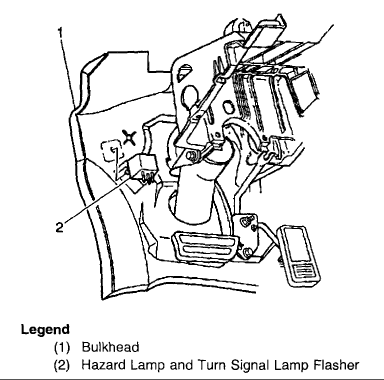

CRUZJFRANCO
how to install the signal flasher
  • 75,992 POSTS
REMOVAL PROCEDURE
Remove the LH instrument panel (IP) insulator.
Pull the hazard/turn signal flasher (2) to release the flasher retainer from the dash mat (1).
Disconnect the electrical connector from the flasher.

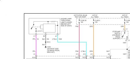

my turn signals stopped working, I replaced the bulbs in the taillights, changed the fuse and changed the flasher unit. my 4-ways work, but not the turn signals. I'm baffled at what is the problem. Any help is surely appreciated. Thank you..............
  • 75,992 POSTS
Test the turn and hazard switch the turn signal circuit goes thru there before it hits the lights

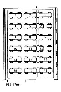

FREUDDREAM
Electrical problem
1992 Chevy Lumina 6 cyl Front Wheel Drive Automatic
Where are the turn signal fuses located?
DOCFIXIT
  • 18,828 POSTS
In glove box fuse #13

FISHERMAN1006
My turns signals don't flash when used. The turn signal light just stays on. I have checked the fuse in slot 13 in fuse box (10amp) and it is not burnt or broken. I even replaced the fuse with another 10amp and still not flashing. Is there a flasher somewhere under the dash, if so where?

ANTNY515
99 Lumina. No turn signals, brakes work, hazards work. Fuses good. Multifunction switch? Any insight. Thanks
Mar 27, 2019 at 11:06 AM (Merged)
  • 75,992 POSTS
If the hazard/turn signal light flasher is okay, get the turn signal switch checked out thoroughly it comes out of there and then to the turn signal lights
