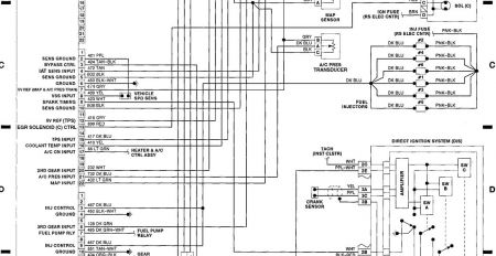

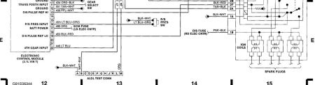

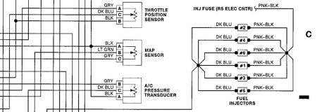

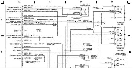

1991 Chevy Lumina no injector pulse or spark
1991 CHEVROLET LUMINA
138,000 MILES • 6 CYL • FWD • AUTOMATIC
RAVENSWOOD1955
found 15 amp fuse blown in r/f fuse and relay center for 3.1 ign. trying to find a wire diagram for the circut that powers up the injectors as I have no 12v potential at the injector harness some wires were chafed behind the power steering pump. All the conduit behind there had rotted away and the wires have been grounding out there.
mainly looking for and over view of the injector and ignition circuts to make repair
Sep 30, 2010 at 1:51 PM
BMRFIXIT
  • 19,053 POSTS
https://images.2carpros.com/forum/automotive_pictures/99387_lum_1.jpg
https://images.2carpros.com/forum/automotive_pictures/99387_lumi_2.jpg
https://images.2carpros.com/forum/automotive_pictures/99387_lumi1_1.jpg
https://images.2carpros.com/forum/automotive_pictures/99387_lumi2_1.jpg
