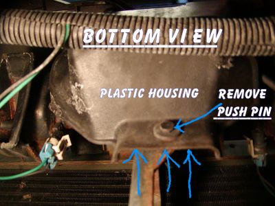

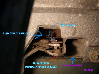

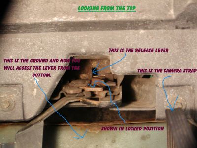

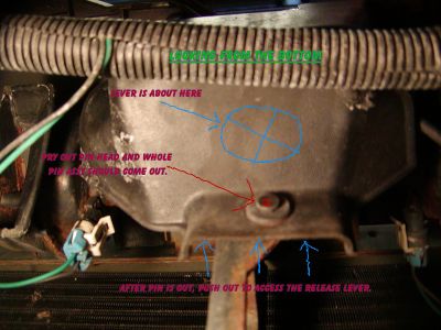

How to open hood when remote cable breaks, handle is located inside car beside drivers seat.cabl;e broke inside cable housing.Thanks, Richard
