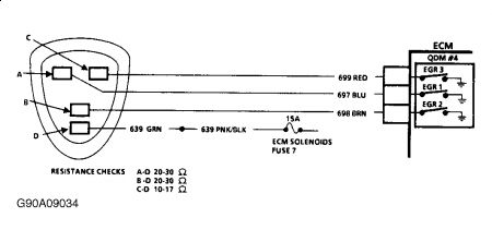

Once I have been driving the car for about twenty minutes and I start to accelerate (when I am driving) not dead stop, it sputters and dies (stalls). The fuel pump was recently replaced, new map sensor, new plugs, new plug wires, fresh oil change, fuel filter looks newer. Service codes are as follows 22, 23, 32, 34. I want it to quit stalling! Any help or places to turn?

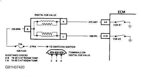

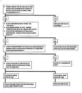

I reset codes and came up with 32 again, then I went and installed new EGR valve from (Auto _one) you know the parts place. Car ran terible I could bearly KEEP IT RUNNING. I returned said part to part store.
I cleaned and reinstalled old EGR valve and car ran a lot better but came up withy new code, 34, but that could have been when it was still running rough. What causes code 34 to show up, high vacuum I know, but what generally causes high vacuum too map sensor.

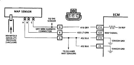

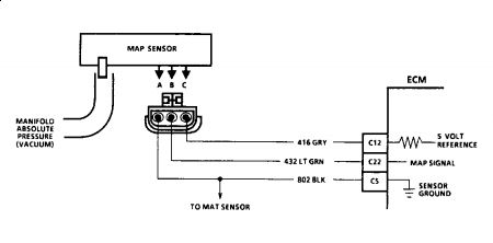

Your EGR is supposed to be a Digital operates with solenoid. Sending some info that may help.
Map sensor test voltage on terminal B. at 1000ft altitude or less 3.8 5.5v at 1000-2000 ft 3.6-5.3 each increase of 1000ft voltage drops .2v. EGR flow chart will take you through diagnosis. maybe small print to enlarge.
