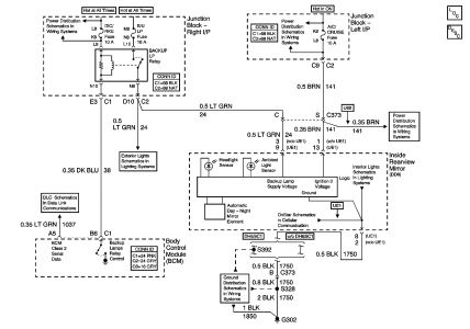

My 2003 Chevy Impala auto dim rear view mirror wires pilled out of the connector and I need to know what color wires go into which pin (1 thru 6), the mirror has map lights and dimmer only?
