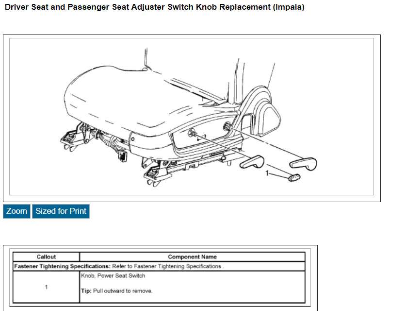

Electrical problem 6 cyl Front Wheel Drive Automatic
replace power seat switch on driver side
Oct 11, 2009 at 3:00 PM
Experienced Mechanic
55,628 POSTS
The job is not bad you can replace the switch in about 15 minutes. Here is a guide to show you what you are in for when doing the job.
https://www.2carpros.com/articles/seat-position-switch-replacement
Here is how it will be like on your car (below)

Hi Ken,
How do you remove the levers shown in your photo attached?

The photo didn't attach. If you can try again I am sure we can figure it out with you. Thanks
Jan 25, 2020 at 6:21 AM
55,628 POSTS
Can you take a picture of the lever? It must have a screw in the middle under a cap?
