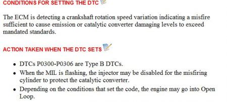

Engine Performance problem
2008 Chevy Impala 6 cyl Front Wheel Drive Automatic
hi my friend has a problem he went have his car check at 3 differnt places the trouble p1174 and p300 came up can u help me to determine the problem
Mar 12, 2009 at 8:48 PM
ZACKMAN
  • 4,202 POSTS

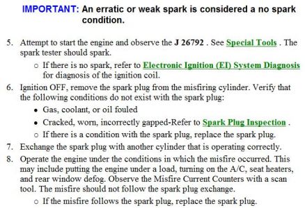

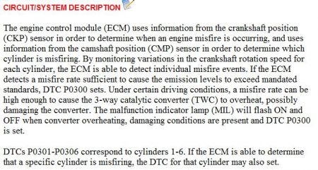

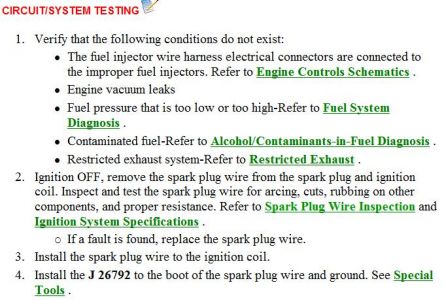

Forget P1174 for the moment. Fix P0300 first, it may fix P1174. If your friend still has the factory warranty available, he/she is better off taking the vehicle back to the dealership. They have the proper equipment to troubleshoot the fault. This is what your friend can do on his/her own.
