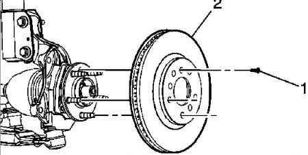

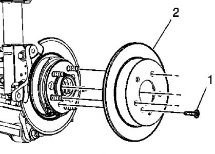

How to remove all 4
Sunday, July 5th, 2009 AT 12:01 PM
MERLIN2021
MECHANIC
17,250 POSTS
Remove caliper and mounting bracket, remove the retaining screw, pull off the rotor. Same at all four wheels!
