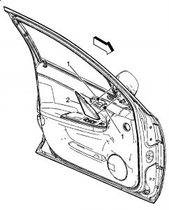

How do I replace the drivers side mirror on a 2007 Chevy Impala. I'm replacing the whole unit and it's not heated.
Sep 3, 2009 at 7:40 PM
BLUELIGHTNIN6
  • 16,542 POSTS
remove the interior trim panel. disconnect mirror electrical connector. remove 3 nuts and replace mirror assembly.

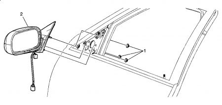

Thanks for the reply. Do I just have to remove the triangular panel by the mirror or I do I have to remove the whole door panel. I don't want to ruin it.
Sep 3, 2009 at 8:01 PM
BLUELIGHTNIN6
  • 16,542 POSTS
yes, just the triangular shape. pull on the top end of the panel to disengage the clips. then lift the panel out from behind the door panel
