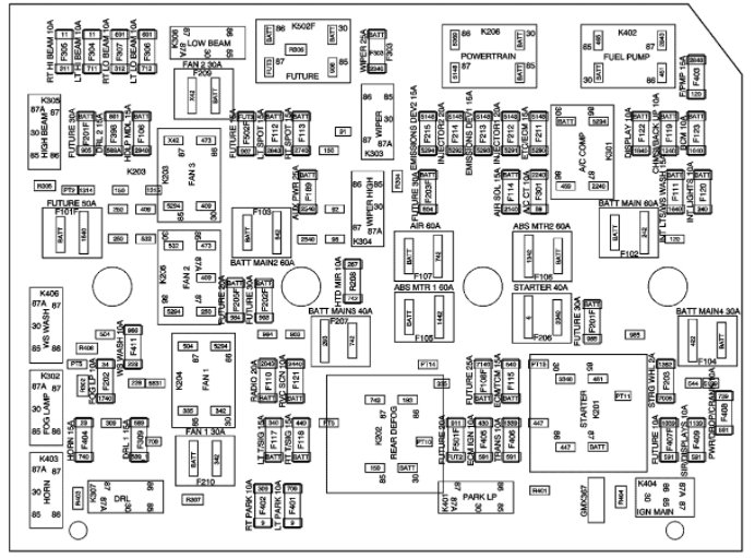

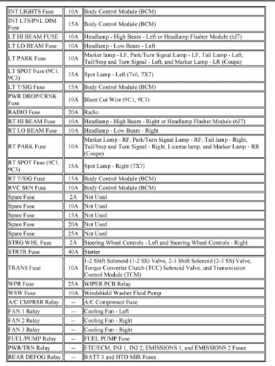

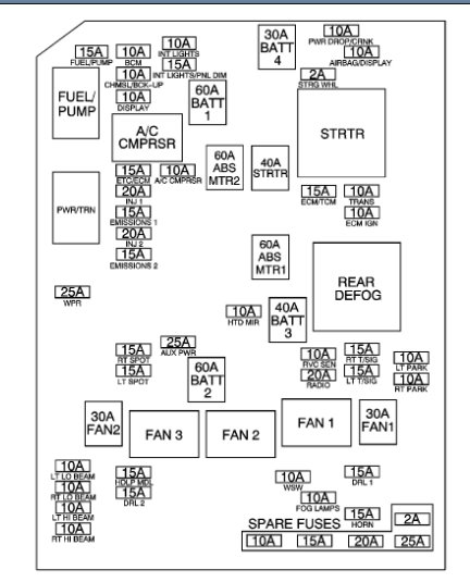

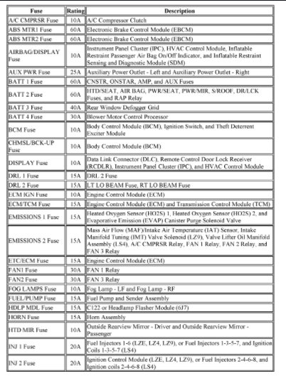

My HVAC system stopped working I need to check the fuses where are they and how do you check them?

Here is the information you requested. Here a few tutorials for you to view on how to check and replace fuse:
I've attached pictures below showing the fuse and relay locations on your car. Hope this helps and thanks for using 2CarPros.
