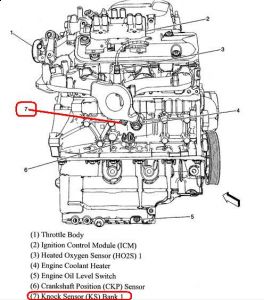

BANK 1 knock sensor.
https://images.2carpros.com/forum/automotive_pictures/261618_b1_1.jpg

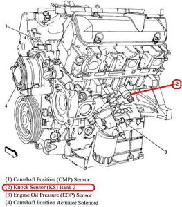

BANK 2 knock sensor.
https://images.2carpros.com/forum/automotive_pictures/261618_b2_1.jpg
