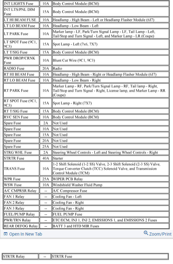

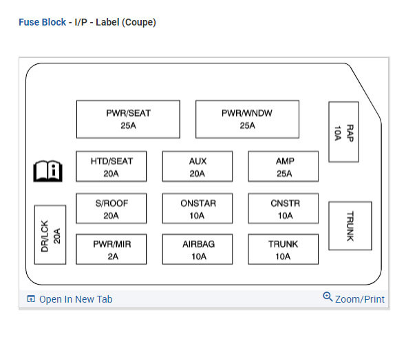

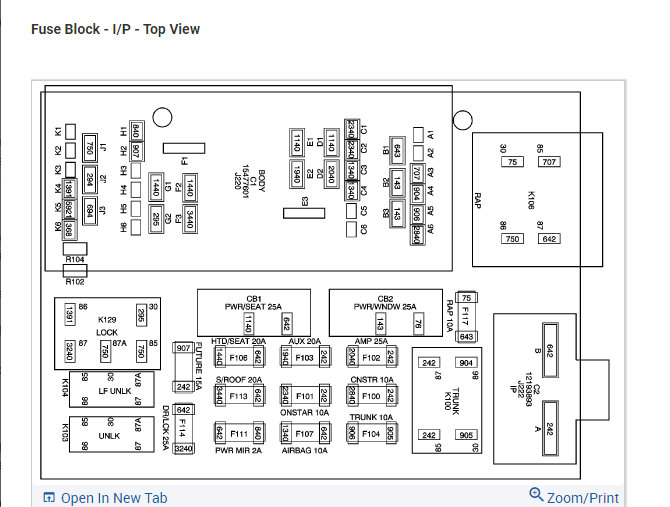

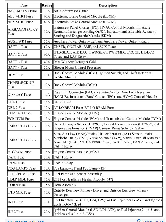

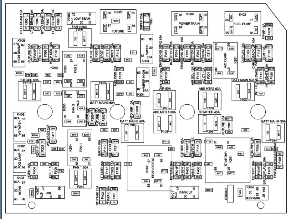

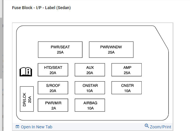

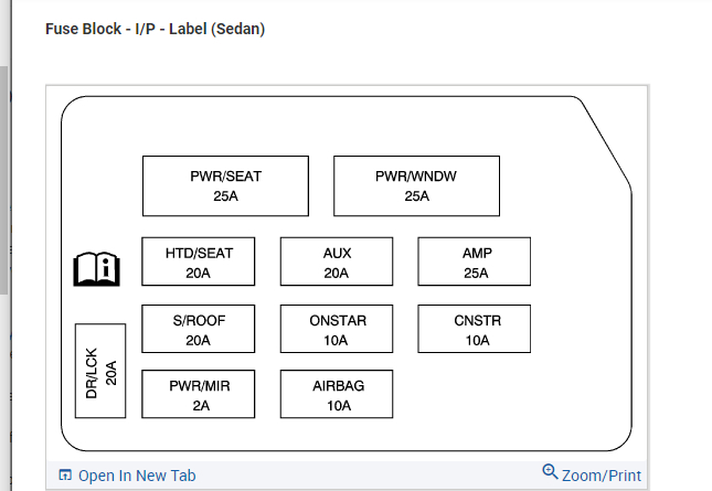

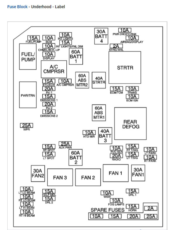

My lights don't work I need to check the fuses.
Tuesday, May 25th, 2010 AT 7:23 PM
Here is a guide that will help with step by step instructions on how to check and replace the fuses:
Also, here is a guide on how to use a test light if you need it:
https://youtu.be/Hlna_kUt7As

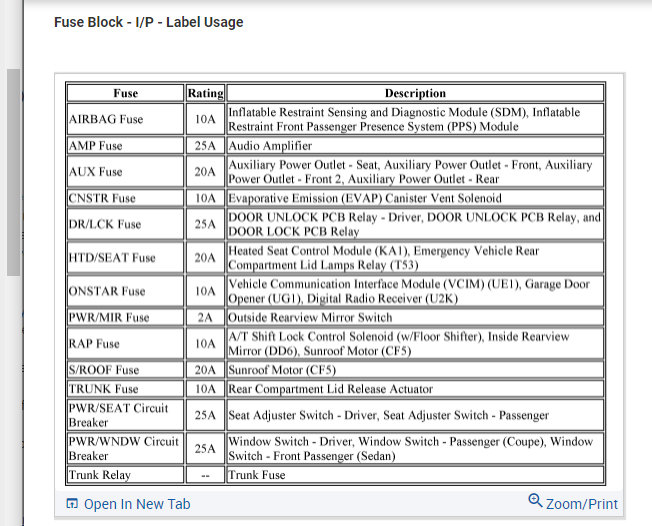

Please run through this and let us know you have other questions on this. The info on the fuses is below.
