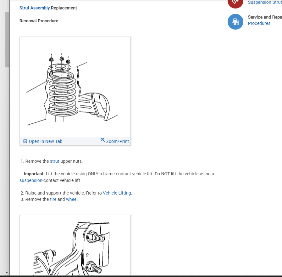

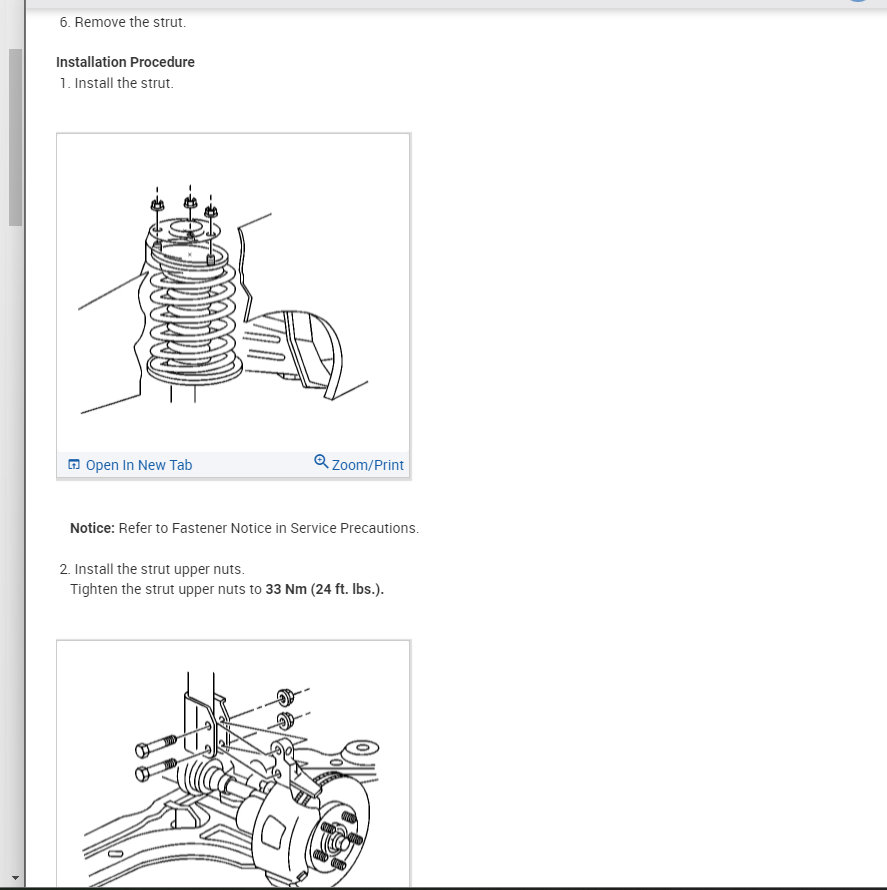

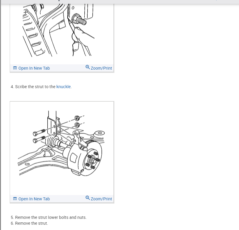

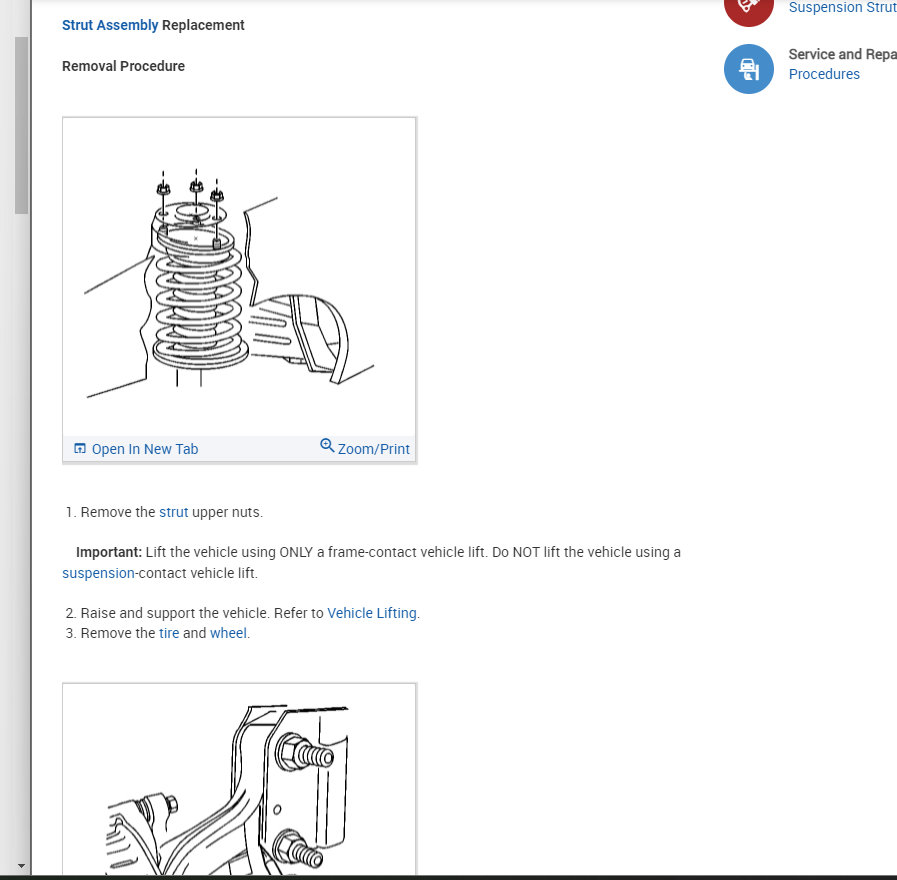

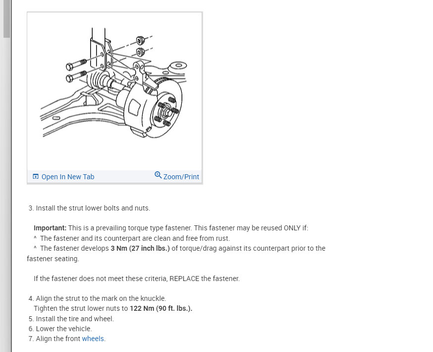

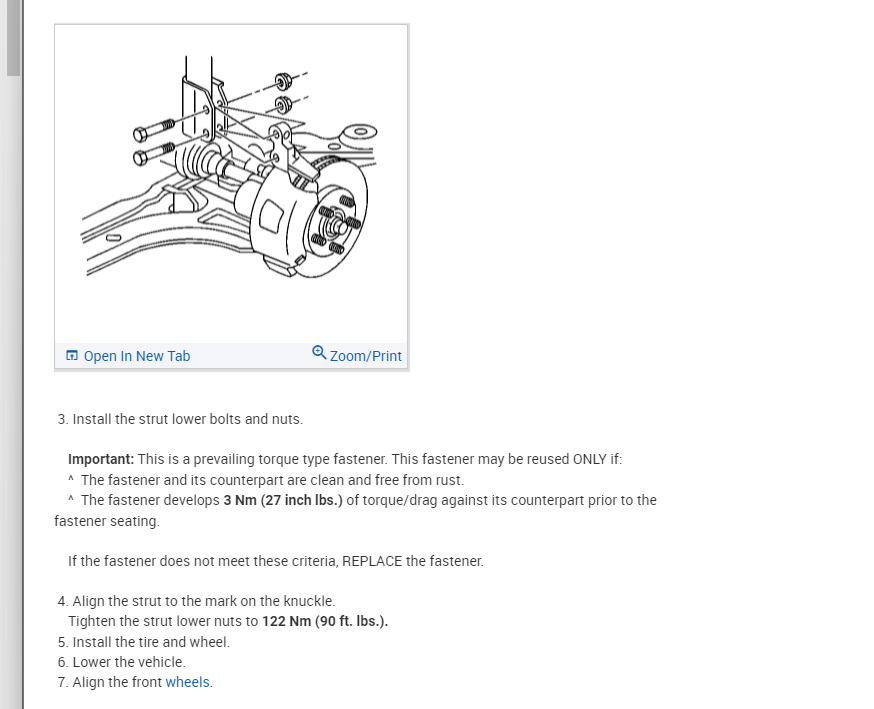

Please see the info below from the manual which is how to replace this. I suspect you will find oil seeping on the assembly, and it is covered in dust and dirt. If it is, then it needs to be replaced.
Please run through this info and let us know what you find.
