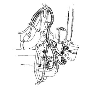

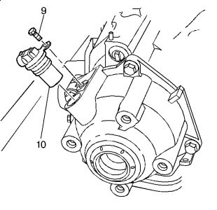

3.4/3 8L engines.
It is on right rear of engine compartment end of trans-axle.
Jun 2, 2017 at 4:03 AM
  • 75,992 POSTS
You need to go through the right front tire and wheel.
https://images.2carpros.com/forum/automotive_pictures/12900_vss1_4.jpg
https://images.2carpros.com/forum/automotive_pictures/12900_vss_20.jpg

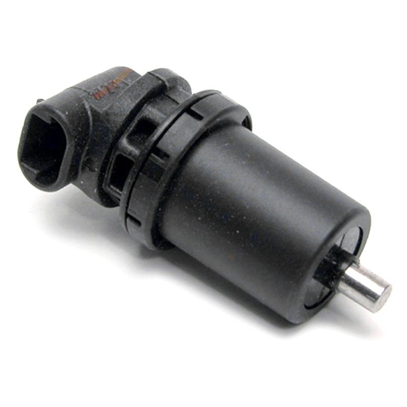

2003 Chevrolet Impala is 3800. looking for the location of the automatic transmission speed sensor (not the VSS). Photo below is of the part i am asking about.
