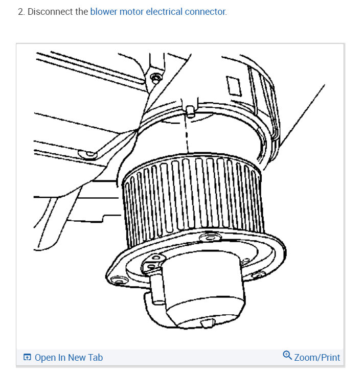

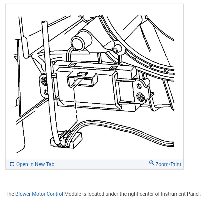

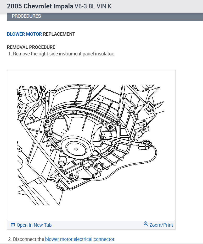

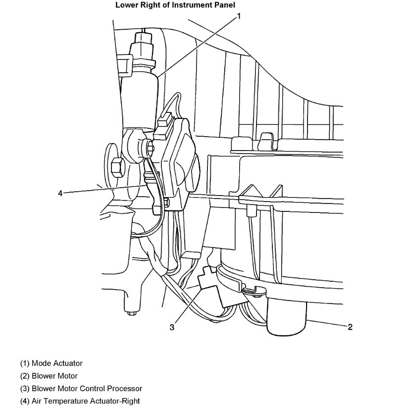

went to work in the morning and it had rained over night and my car was wet. turned on the fan for my heater and got nothing. still had heat but fan wasnt running. than i smelled burning electronics and a little smoke came out of one of my vents. so naturally im thinking something shorted out. checked the 30amp fuse under the hood and it was blown. replaced the fuse with my car turned off(keys werent even in the ignition). the second i put the fuse in, my blower motor was blowing air on high without the car having the keys in it. put the keys in turned the car on tried selecting a different speed setting on the fan and it just stays on high even with the fan set to off. i have to either unplug the blower motor from under the glove compartment or take out the fuse to get the motor to stop running even if my car is running or doesnt have the keys in it. the burning smell was very strong so i think whatever shorted out and fried is inside the car. i also checked all my fuses related to the climate control system and fans and there were all good. im thinking it could be my blower motor resistor. any ideas on what the problem might be?
Jun 4, 2010 at 1:26 AM
SATURNTECH9
  • 30,869 POSTS

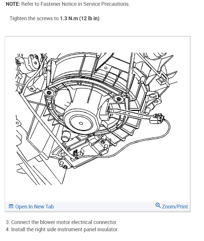

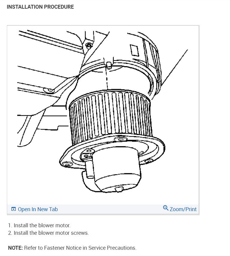

There is a blower motor speed controller that has shorted out which causes the blower motor to stay on. This happens when the blower motor needs to be replaced because it is overloading the speed control module which is right next to the blower motor. Here is its location so you can get it replaced. It is right next to the blower motor. diagram (below) Please let us know what happens.

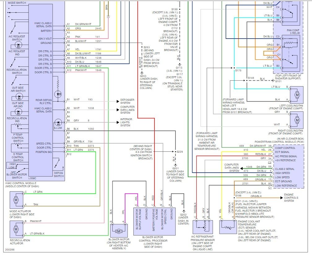

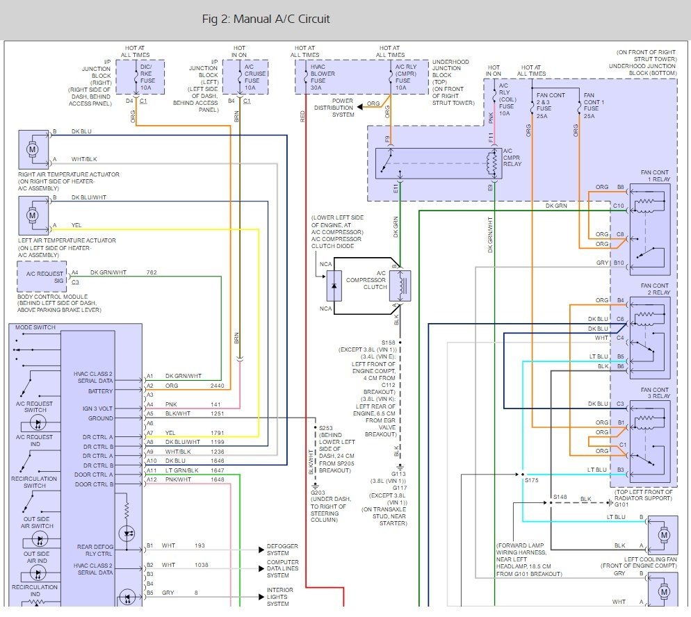

Hi DARIUS,
It sounds like it is a blower motor speed control module. Here is a wiring diagrams so you can do some testing with a guide as well. The blower motor is at the bottom of the second diagram.
Please run some tests and get back to us so we can continue helping you.
Best, Ken

  • 16,542 POSTS
i believe it's part of the blower motor control module which is attached to the blower motor, that is behind the passenger side dash so yes it is difficult to access.

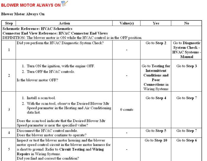

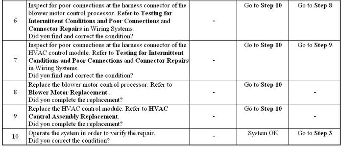

Here are the diagnostics for the problem.

BLUELIGHTNIN6
  • 16,542 POSTS
First inspect the relay. If relay is OK, check the blower module. If blower is now running with key off, remove main connector , if it turns off then you need to replace the blower module.

Hi:
There is a blower control module that goes on leaving the blower motor running here is the location so you can change it out in the diagrams below. Check out the diagrams (Below). Please run this test and get back to us.
