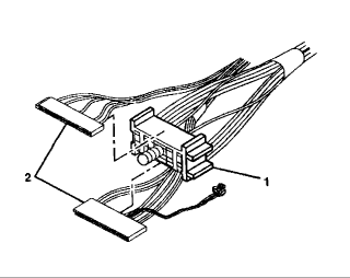

How do I get the plastic cover off to replace the turn signal switch. I could get the bottom loose but couldn't get the top loose or any of it removed.
Do I need to remove steering wheel? I hope not!
Please give me a step by step to replace this switch.

Multifunction, Turn Signal Switch Replacement Removal Procedure Caution: Refer to SIR Caution in Service Precautions.
https://images.2carpros.com/forum/automotive_pictures/12900_t1_10.gif
Disable the SIR system. Remove the upper and lower trim covers. Important: The abrasion sleeve located on the steering column wire harness assembly must be reinstalled. Make note of what connector is coming out of the abrasion sleeve for installation purposes. Remove the wire harness assembly (1) from the wire harness strap (2). Disconnect the turn signal and multifunction switch assembly connector from the SIR system coil connector.
https://images.2carpros.com/forum/automotive_pictures/12900_t2_10.gif
Slide the 2 connectors (2) of the turn signal and multifunction switch assembly out of the bulkhead connector (1).

Slide the 2 connectors (2) of the turn signal and multifunction switch assembly into the bulkhead connector (1).
