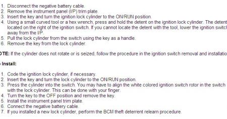

how to remove ignition switch when it is stuck or will not turn

https://images.2carpros.com/forum/automotive_pictures/170934_lock_cylinder_2.jpg
That is for the lock cylinder, If it won't work that way, you may have to remove the switch.
