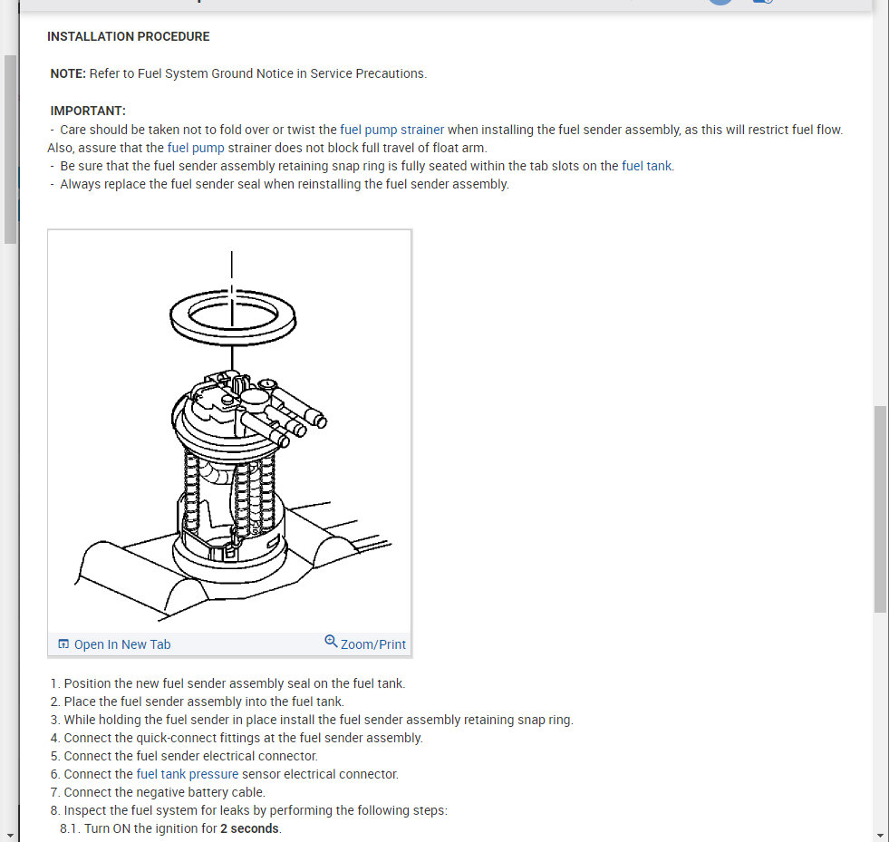

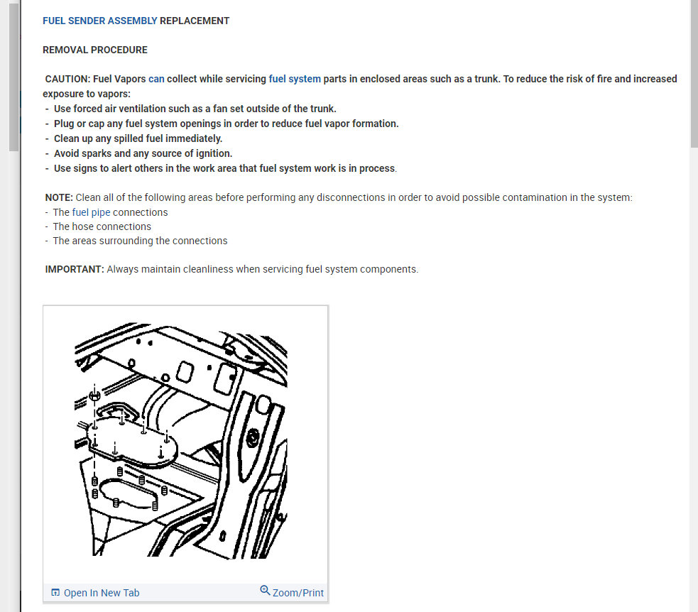

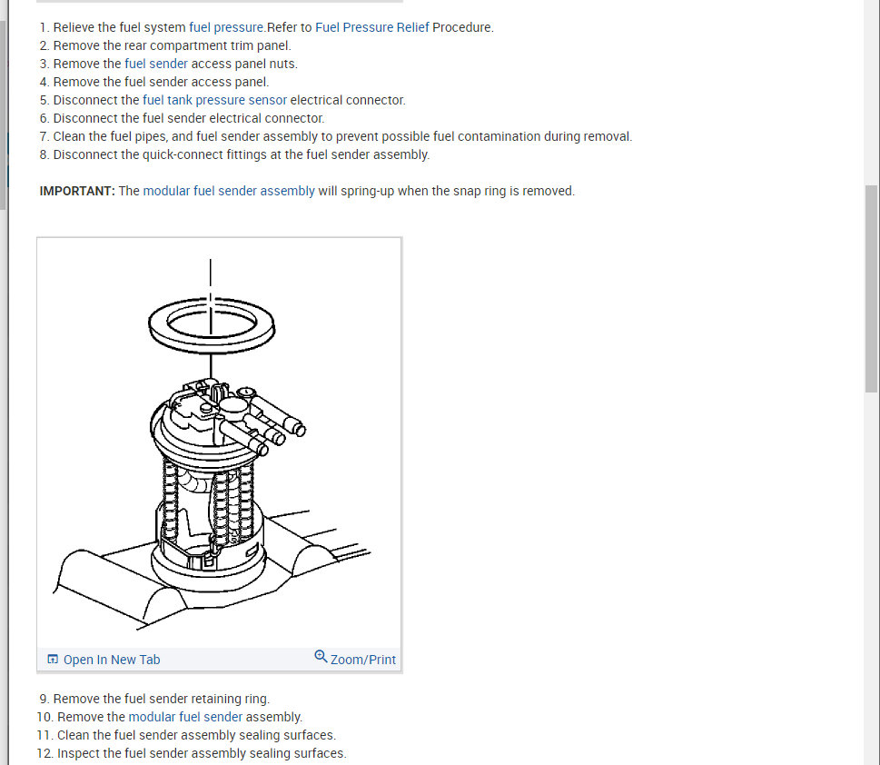

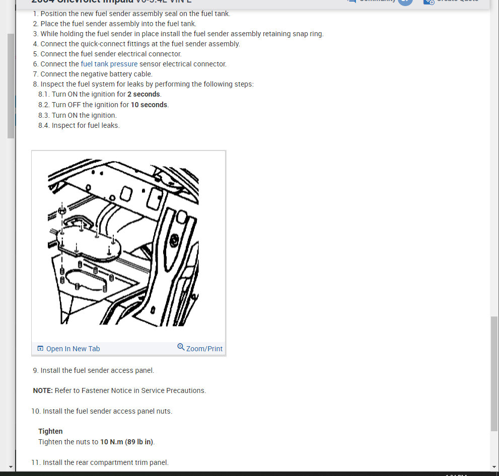

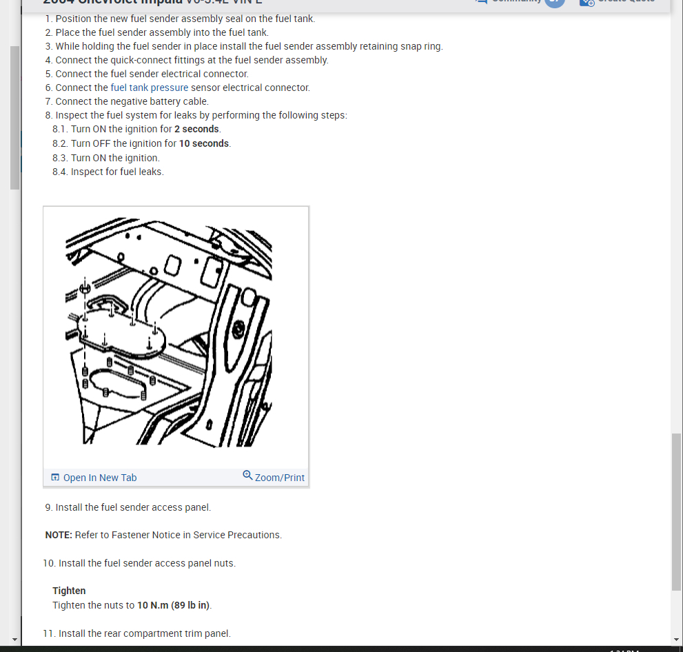

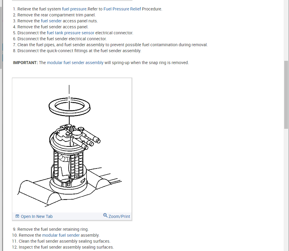

Is there an access panel to get to the fuel pump on this model?
Mar 28, 2010 at 5:44 AM
Yes there is a panel on these vehicles. Here are a couple guides that will help with testing and replacement but I also attached the info from the manual:
https://www.2carpros.com/articles/how-to-replace-an-electric-fuel-pump
Below you will see the process from the manual that will give the detail that you need to replace this. Please let us know if you have other questions. Thanks
