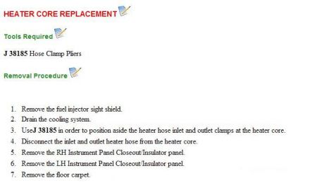

I just got this 2004 impala police car. I found coolant inside on floor. I can tell it flow from the center of underneath control console.
Can any one give me idea how to fix it?

If coolant is leaking into the floorboard from behind the dashboard then this indicates a fault with the heater core. Inspect your heater core and the heater hoses leading to the core. Either the hose(s) or the heater core itself needs replaced. If you need assistance removing and replacing the heater core just let me know.

Thanks. Could you give me some instruction on how to replace heater core or hose?

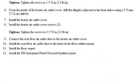

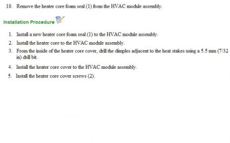

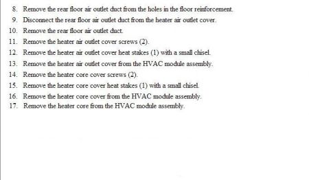

https://www.2carpros.com/forum/automotive_pictures/261618_Noname_1134.jpg
https://www.2carpros.com/forum/automotive_pictures/261618_Noname2_325.jpg
https://www.2carpros.com/forum/automotive_pictures/261618_Noname3_122.jpg
https://www.2carpros.com/forum/automotive_pictures/261618_Noname4_62.jpg
https://www.2carpros.com/forum/automotive_pictures/261618_Noname5_28.jpg
