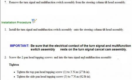

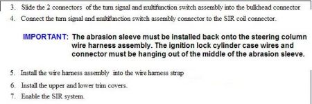

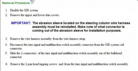

How hard is it to replace the Combo Sw which includes the cruise control, windshield wiper Sw, light dimmers Hi/lo beam...? Right now, only my daylight running lights work...I can get Hi beams on but I have to hold lever they will not stay on by self.

https://images.2carpros.com/forum/automotive_pictures/261618_Noname_1175.jpg
https://images.2carpros.com/forum/automotive_pictures/261618_Noname2_343.jpg
https://images.2carpros.com/forum/automotive_pictures/261618_Noname3_130.jpg
