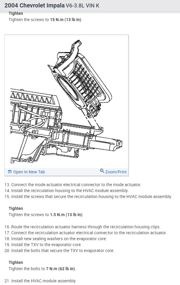

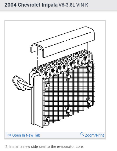

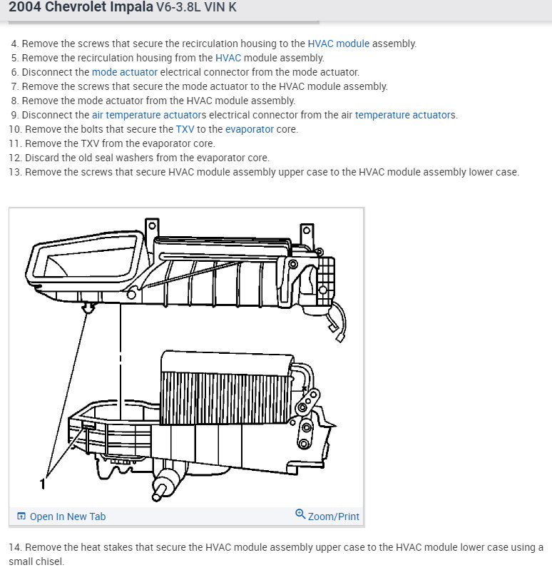

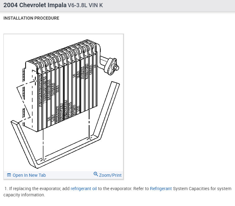

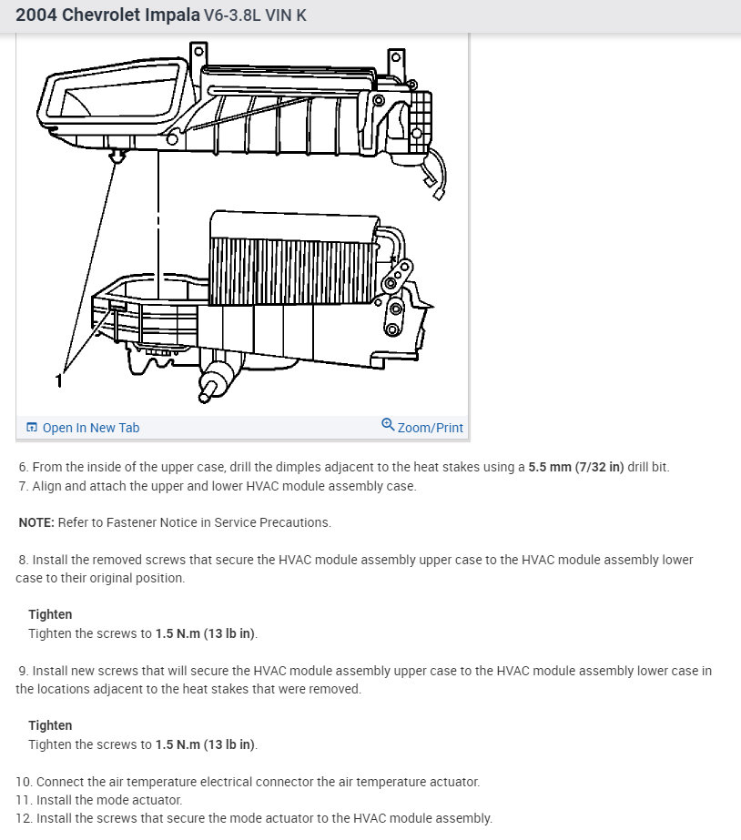

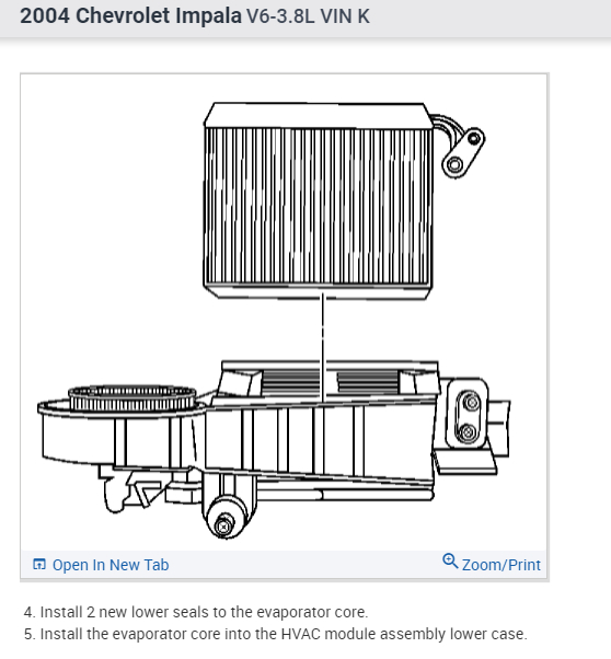

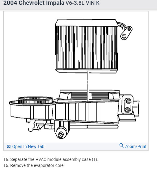

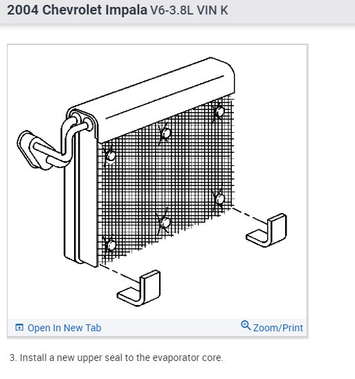

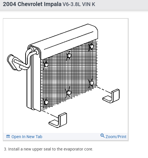

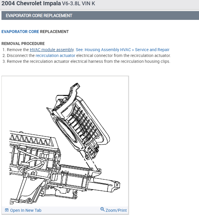

I have attached the evaporator replacement procedures below for your reference.
Dec 4, 2021 at 8:44 PM
