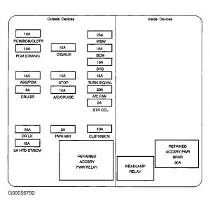

You will have to scan for "B" codes with a scntool that is able to do this, most shops can scan B cods, and the dealer too. Try pulling the retained accessory power relay. It's on the top of the fuse box, and the breaker is on the bottom of the fuse box, after you remove it, see if the windows are now powered down.
https://images.2carpros.com/forum/automotive_pictures/62217_relays_1.jpg
