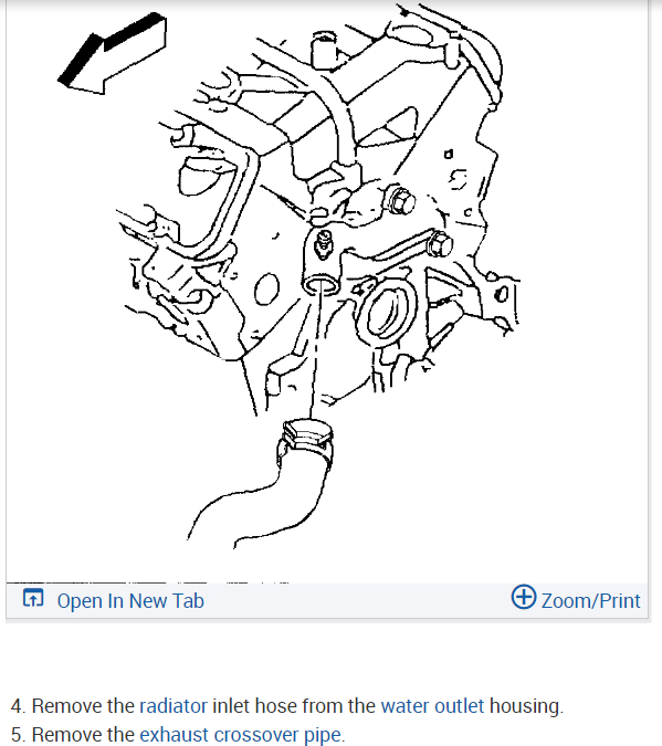

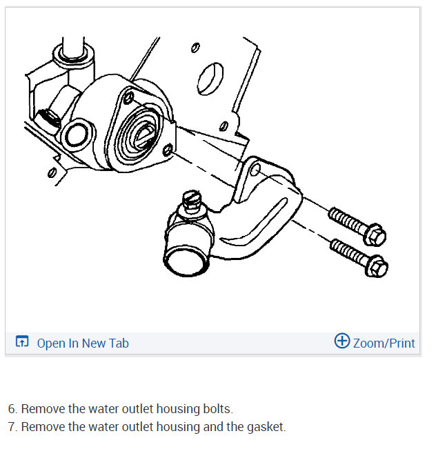

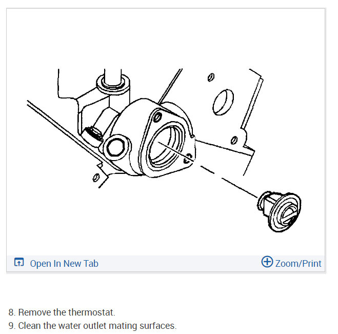

The P0128 code indicates that the engine is not reaching the proper operating temperature in a specific timeframe. This means the thermostat is stuck open and needs to be replaced, here is how to do the job in the images below.
