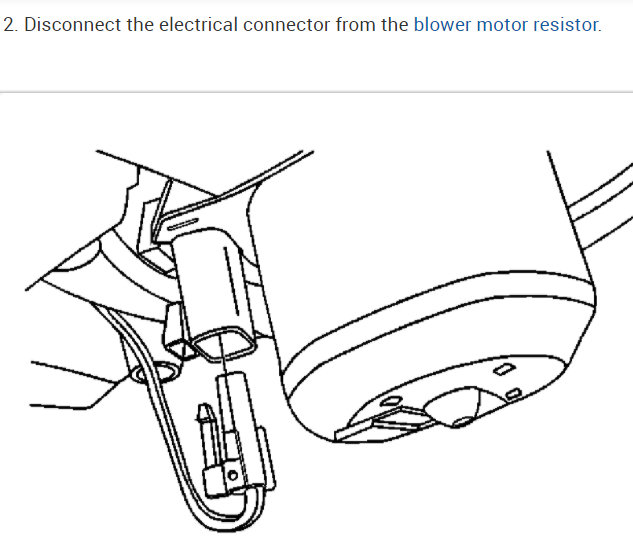

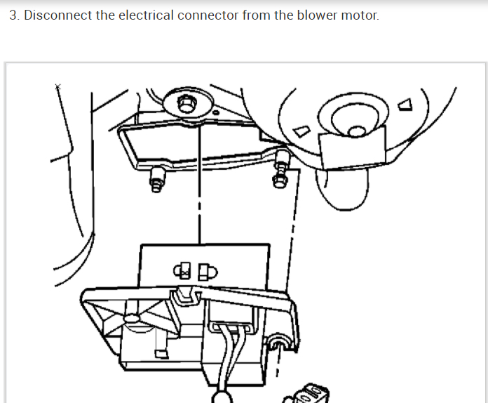

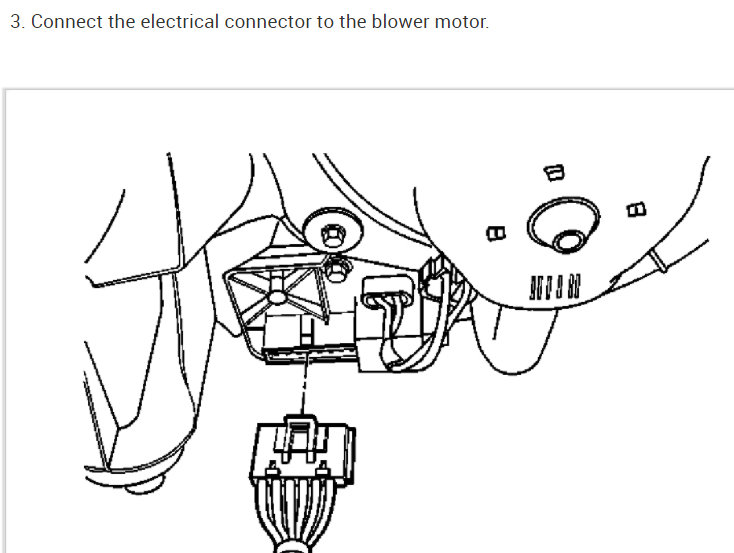

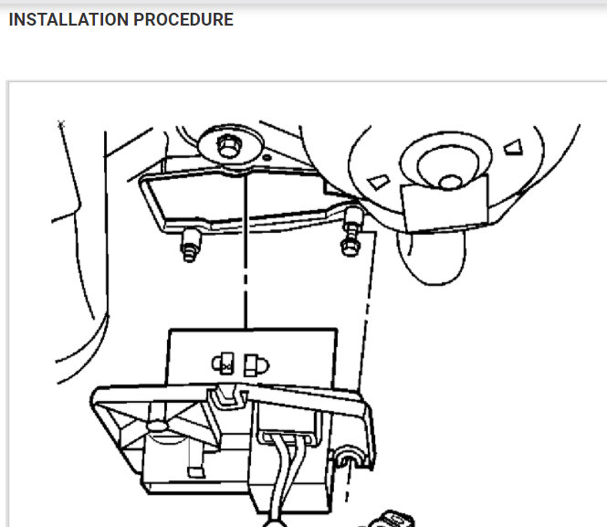

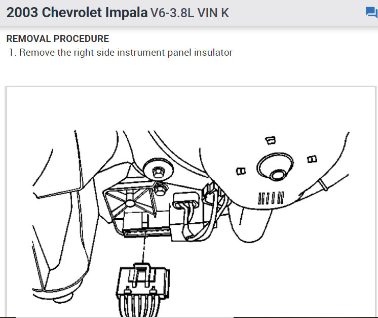

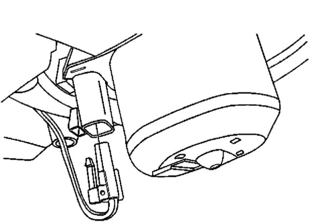

I am unable to locate the blower motor resistor which I believe is under the passenger side of the dashboard. Would you please provide a schematic of the blower motor resistor location. Thank You.
Thursday, June 19th, 2008 AT 1:34 PM
DANNY L
  • 5,648 POSTS
Hello, I'm Danny.

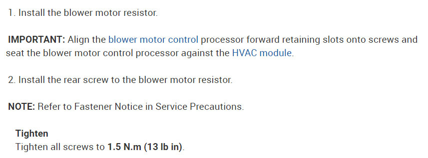

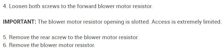

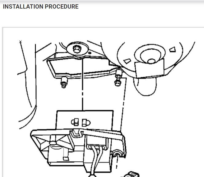

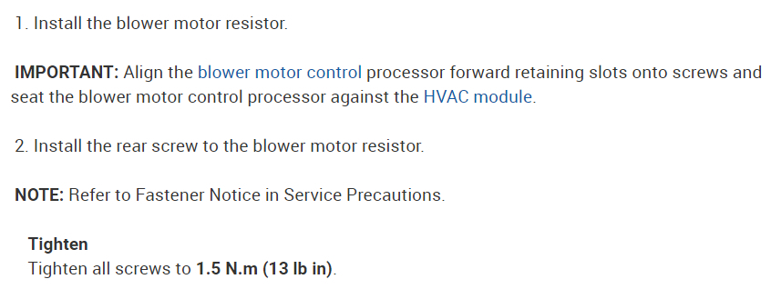

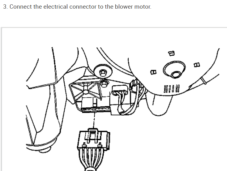

The blower motor resistor is mounted to the left of the blower motor. I've attached picture replacement steps below of the resistor including the location. Hope this helps and thanks for using 2CarPros.
