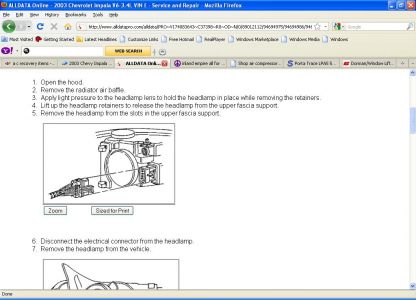

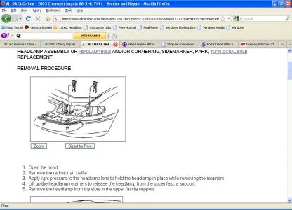

how do i replace the whole headlight on the passenger side? just to make myself clear, i mean the entire headlight and not jus the bulbs.
Jul 29, 2010 at 4:44 AM
SATURNTECH9
  • 30,869 POSTS
https://images.2carpros.com/forum/automotive_pictures/416332_2003_chevy_impala_headlight_part1_1.jpg
https://images.2carpros.com/forum/automotive_pictures/416332_2003_chevy_impala_headlight_part2_1.jpg
There you go.
