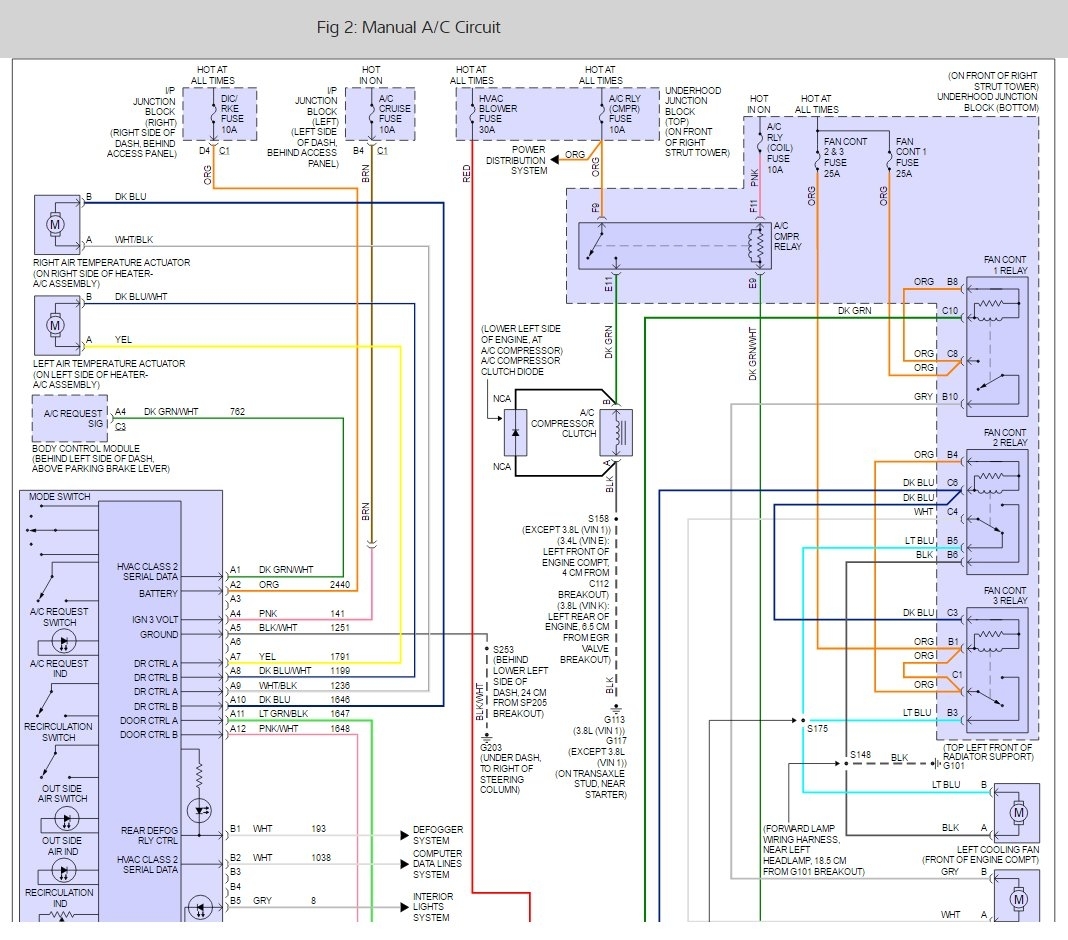

this vehicles climate control will not come on, the blower motor is not working,the a/c button doesn't light up when pressed.i found that in the fuse block on the drivers side of the dash that the blower motor fuse has no power. if i supply that fuse with power then everything works normally.all other fuses are good. my main question is,where does this fuse receive power from. thank you for your help in advance.
Aug 4, 2010 at 5:04 AM
BLUELIGHTNIN6
  • 16,542 POSTS
Hello and thanks for donating
According to the schematics, the A/C Blower Fuse (25 amp) will have an orange wire going to the blower motor relay. Have you tested the relay out? From the relay it will go to multiple places, including the blower motor itself and the HVAC Control Module.

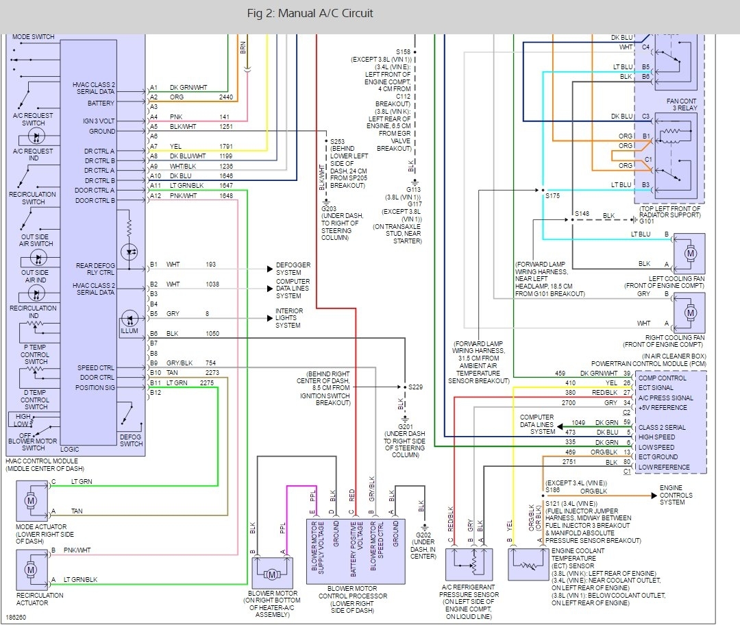

ok,thanks. is there any way i could get a wiring diagram of this circuit?
Aug 5, 2010 at 7:38 AM
BLUELIGHTNIN6
  • 16,542 POSTS
sure it's rather large though and probably not readable on this forum, so i have sent it to your email on file as well. (UPDATED WIRING DIAGRAMS LOCATED AT THE BOTTOM OF THIS POST)

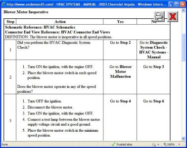

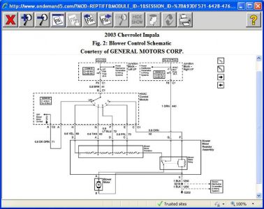

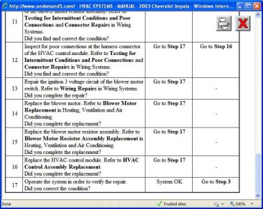

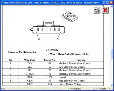

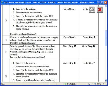

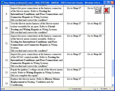

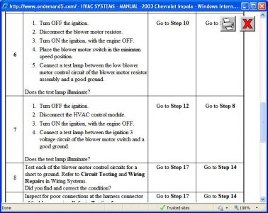

SATURNTECH9
  • 30,869 POSTS
What model impala do you have?Also do you have manual or auto climate control?Let me know so i can get you the correct information.
Apr 10, 2017 at 7:54 AM (Merged)
CRPGNUT
3.8 V6 and I guess manual climate control. I have to press a button to turn it on or off. There's no letters after my Impala name. It's not a LS or anything.
SATURNTECH9
  • 30,869 POSTS
https://images.2carpros.com/forum/automotive_pictures/416332_2003_chevy_impala_blower_motor_inop_part1_1.jpg
https://images.2carpros.com/forum/automotive_pictures/416332_2003_chevy_impala_blower_motor_inop_part2_1.jpg
https://images.2carpros.com/forum/automotive_pictures/416332_2003_chevy_impala_blower_motor_inop_part3_1.jpg
https://images.2carpros.com/forum/automotive_pictures/416332_2003_chevy_impala_blower_motor_inop_part4_1.jpg
https://images.2carpros.com/forum/automotive_pictures/416332_2003_chevy_impala_blower_motor_inop_part5_1.jpg
https://images.2carpros.com/forum/automotive_pictures/416332_2003_chevy_impala_blower_motor_inop_part6_1.jpg
https://images.2carpros.com/forum/automotive_pictures/416332_2003_chevy_impala_blower_motor_inop_part7_1.jpg
https://images.2carpros.com/forum/automotive_pictures/416332_2003_chevy_impala_blower_motor_inop_part8_1.jpg
There you go.

If it's not working at any speed it's a good chance it's the blower motor.Bad news it's under the hood area at the base of the windshield.You have to remove the wiper arms cowl cover wiper motor with wiper transmission then there is a cover over the blower motor.Also care has to be taken putting the blower motor cover back on.Otherwise the blower motor wheel will rub on the blower motor cover.if you turn the blower motor on the highest setting.Your looking for power on the yellow wire under the dash on the passenger side of the dash.
Apr 29, 2017 at 1:22 AM
SATURNTECH9
  • 30,869 POSTS
There is a blower motor resistor card with a plug towards the center of the dash under it on the passenger side that's where your looking for the battery voltage.
