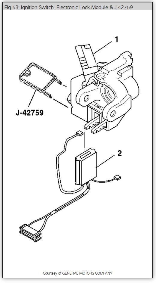

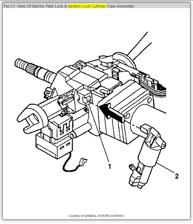

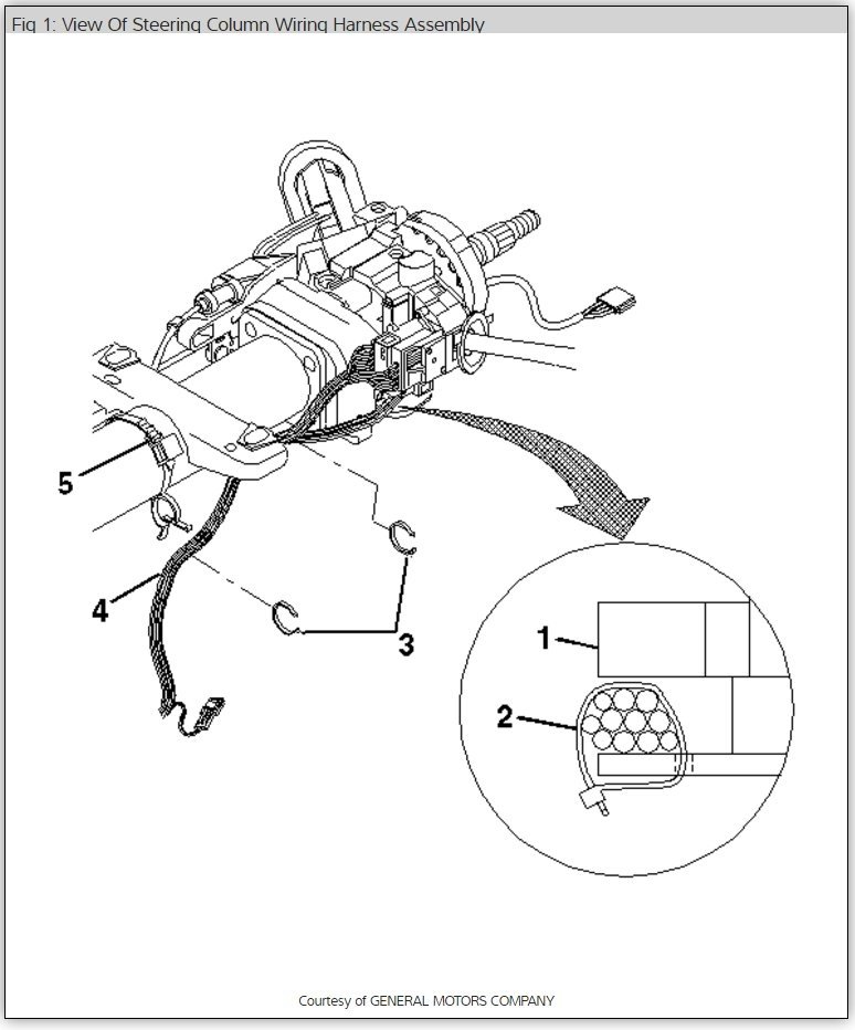

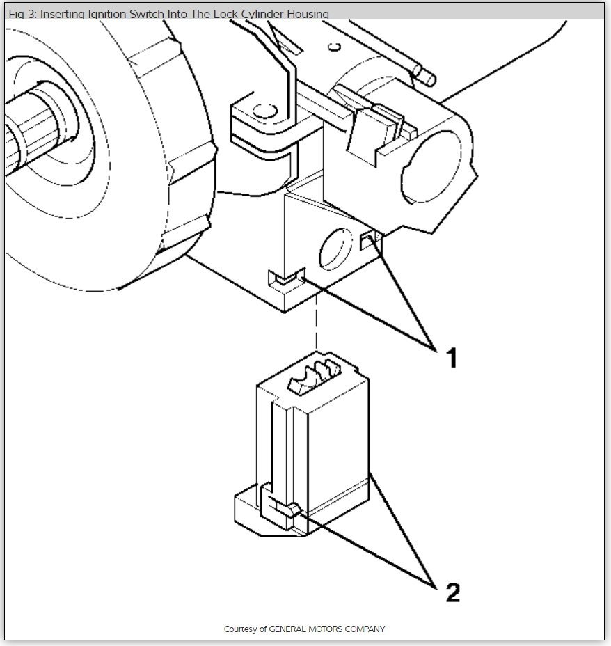

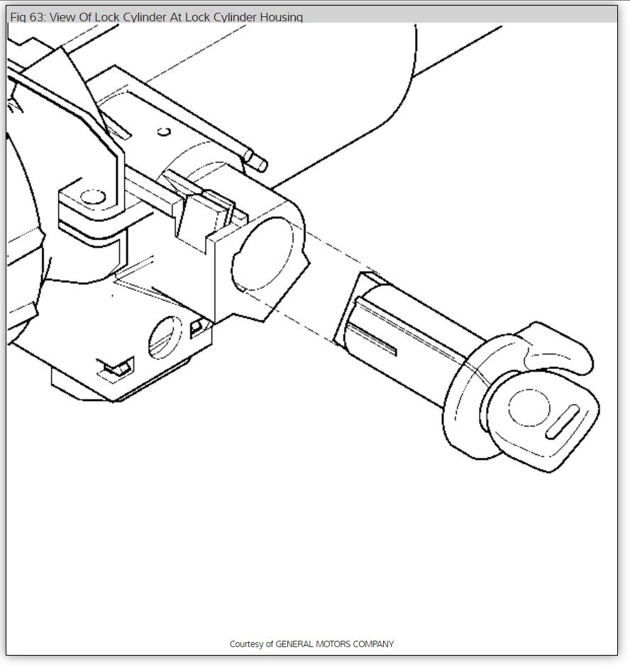

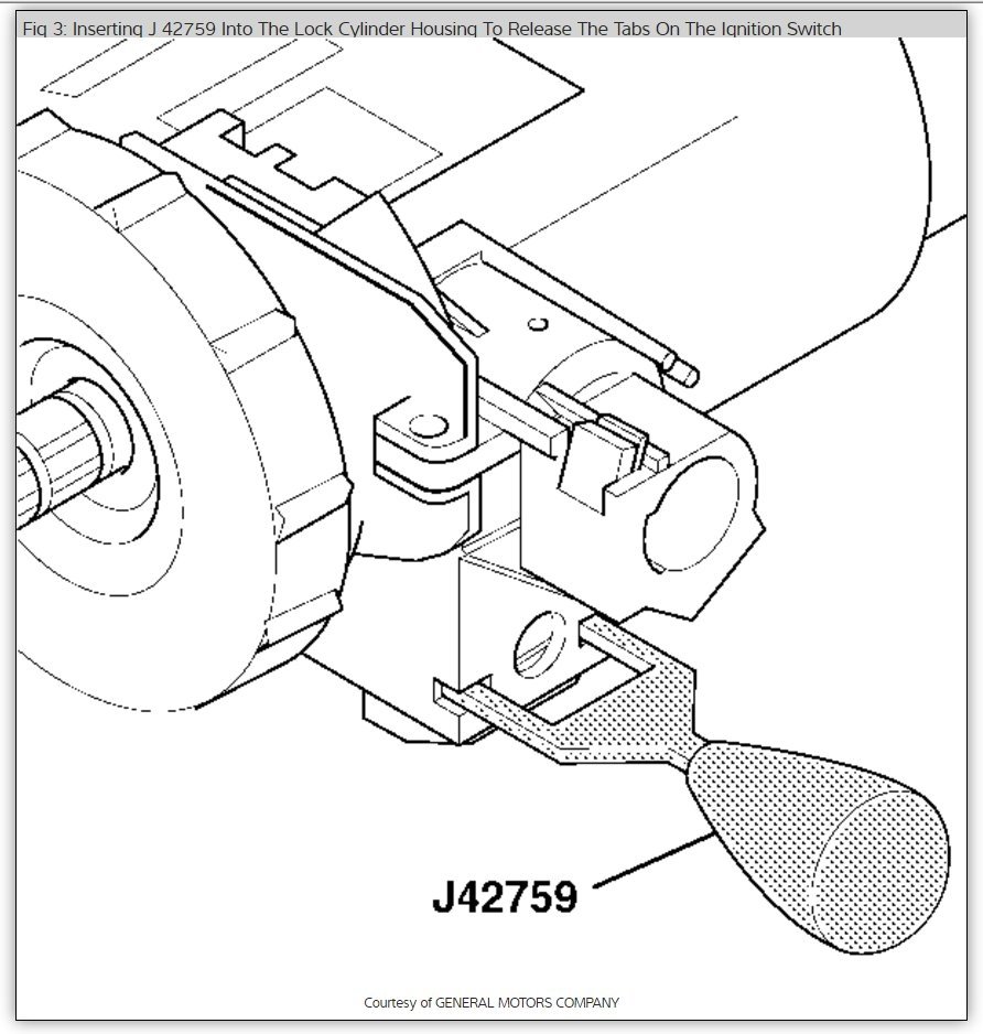

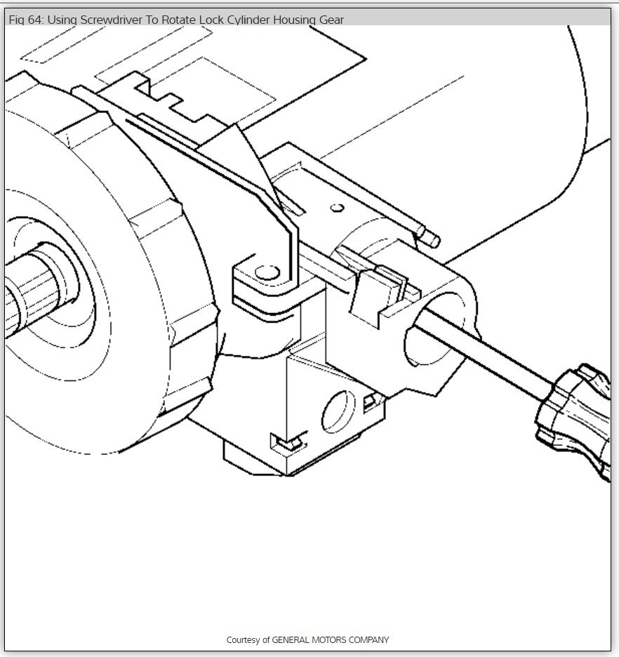

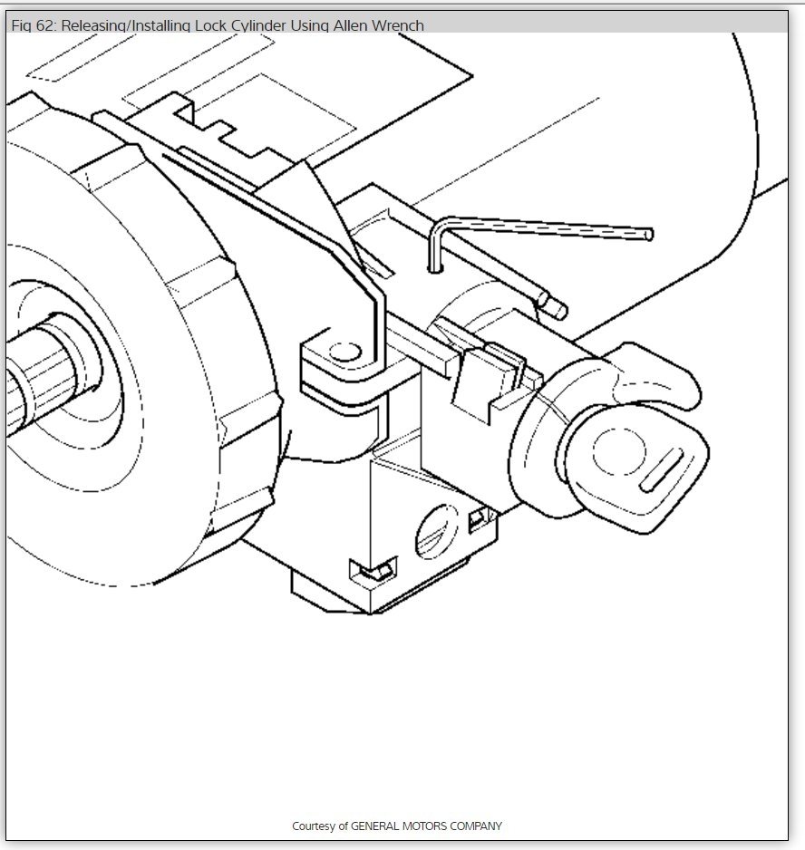

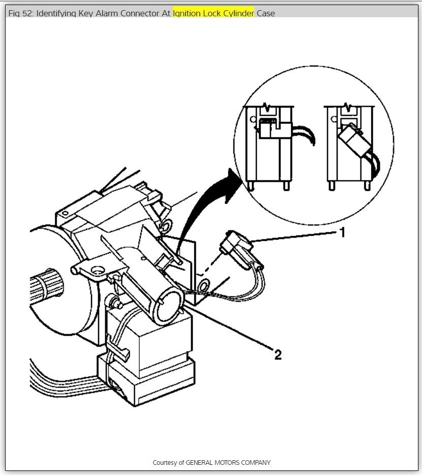

The first thing I would look at is your key is it worn down if so that could be the problem. Do you have a spare that is not worn down? If not I would go to the Chevrolet dealer and have them make a fresh punched out key from your key code. Not having a worn out copy of your old key made. Also, have you tried moving the steering wheel back and forth while trying to turn the key? Also try lightly tapping on the ignition cylinder with a hammer then turning the key. If that does not work you will need to replace the lock tumbler. Here are diagrams to help show you how.

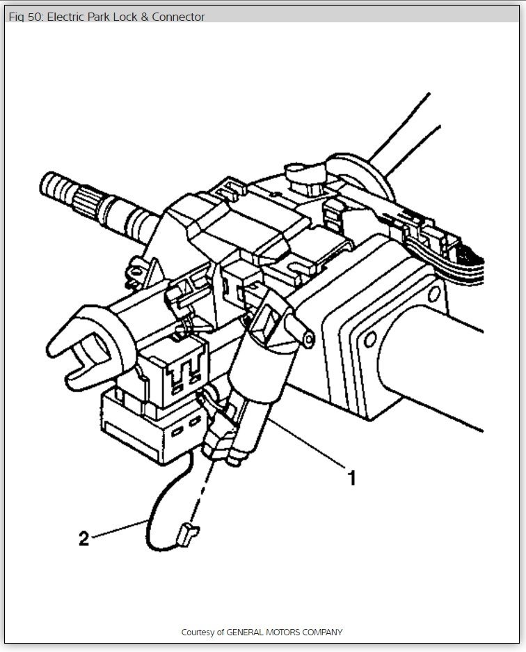

Alright, use the instructions for replacing the ignition cylinder as far as taking the dash panel's off etc. Once you do that then make sure the car is in park with all the cables put back in place. Then see if you can depress the retainer that holds the trans-axle park lock cable in place on the ignition switch if you can then remove the cable. Now see if the ignition key turns if it does then we have a problem with the cable binding up the cable. If it does not then we have to remove the whole assembly and drill out the cylinder. Let me know what you find.
