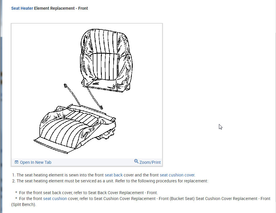

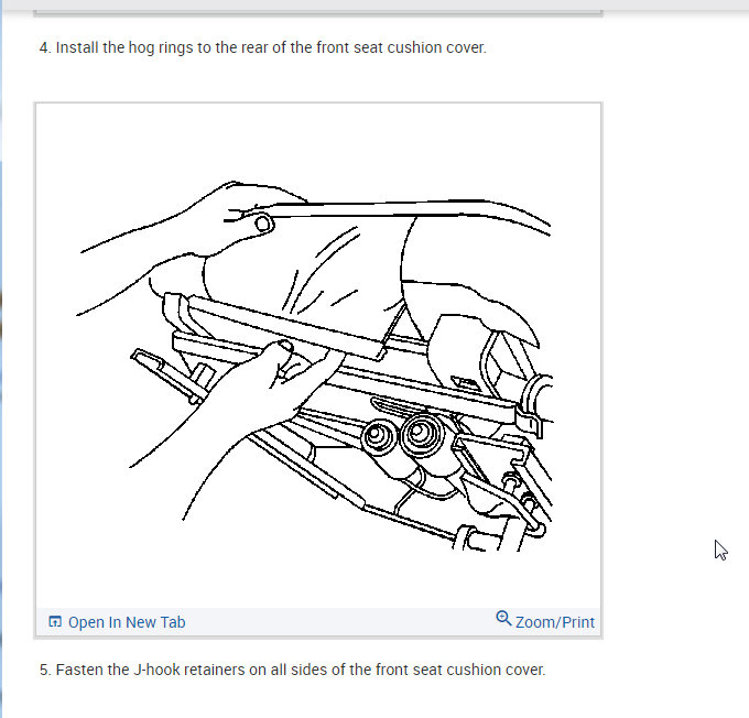

Is there an easy way to replace the front seat heater in the bucket seats?
Jan 27, 2009 at 6:33 AM
RHALL77
  • 3,361 POSTS

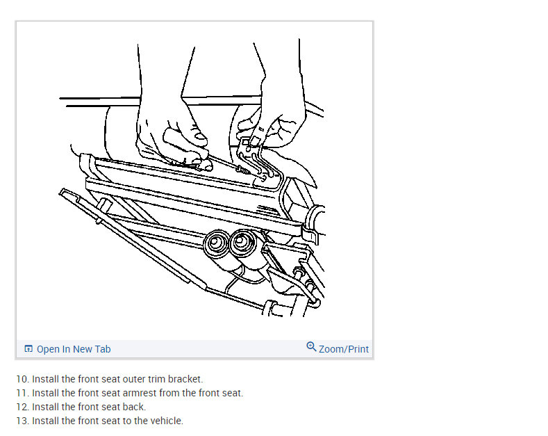

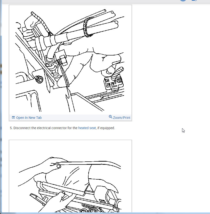

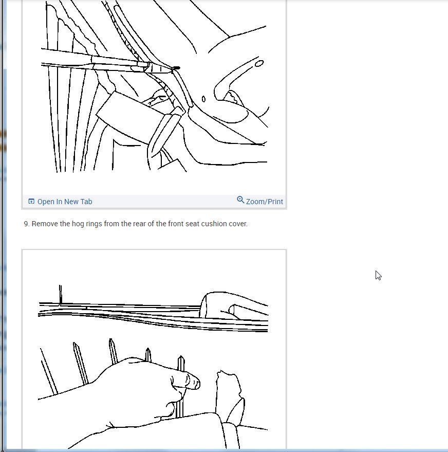

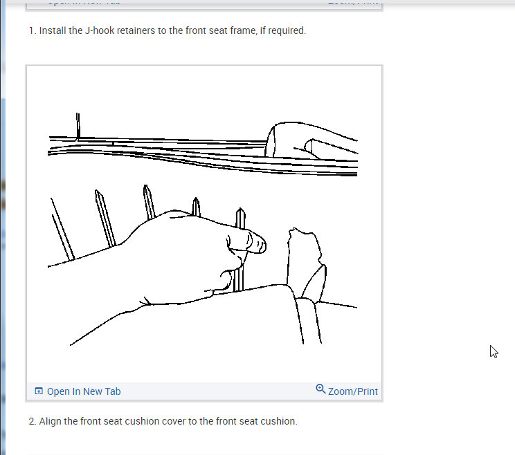

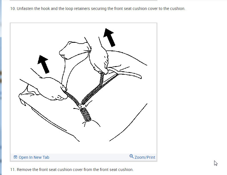

basically remove the bolts, disconnect the electrical connectors and slide it out. Here are the instruction in the diagrams below to help you.

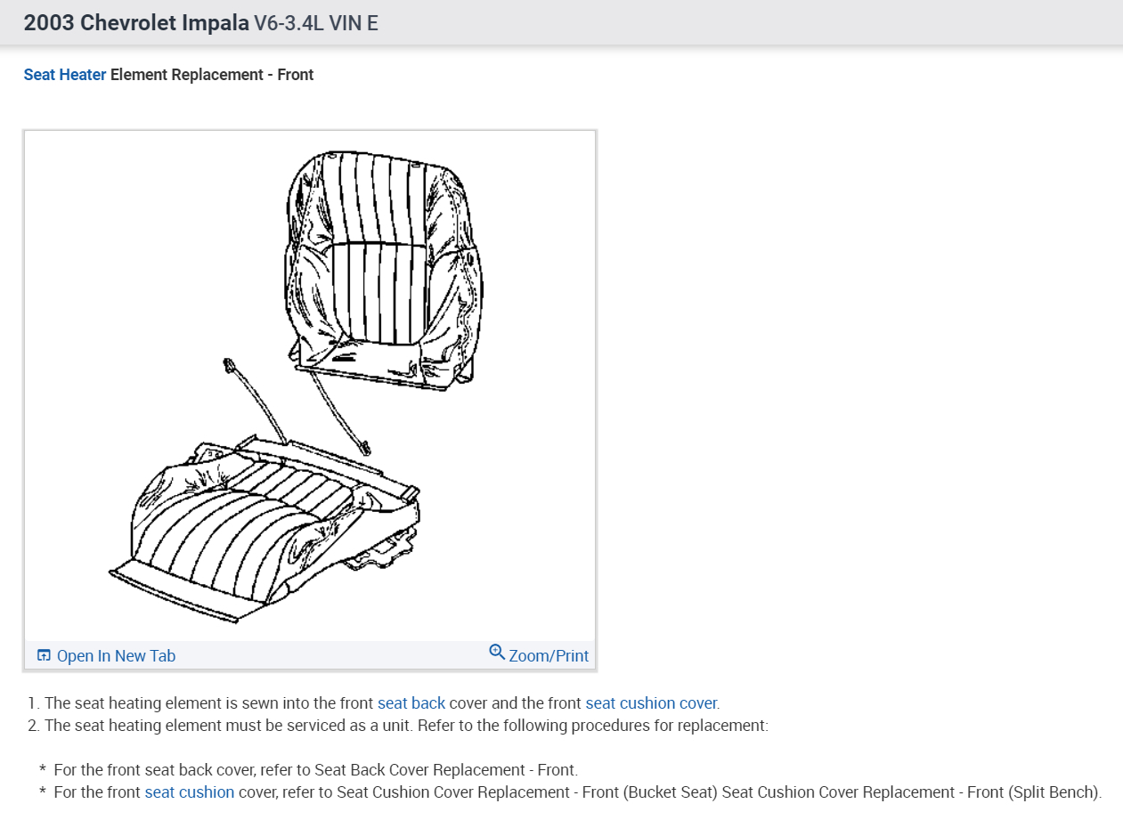

KIMMERER RIZOR TRIPP

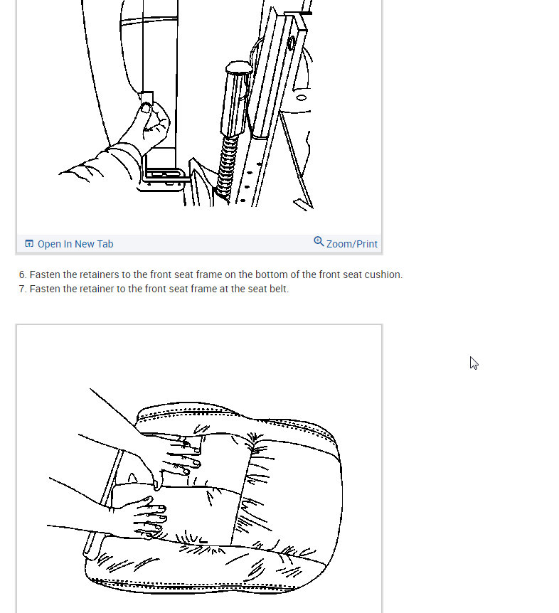

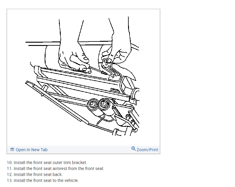

How can I get an original heating element for the drivers side seat on my Impala?
Nov 11, 2020 at 4:48 AM

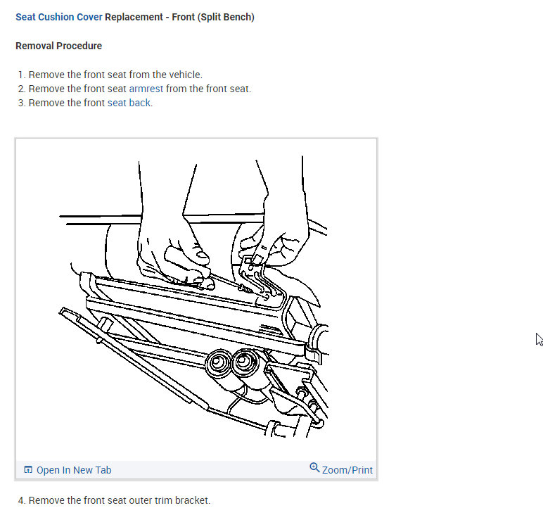

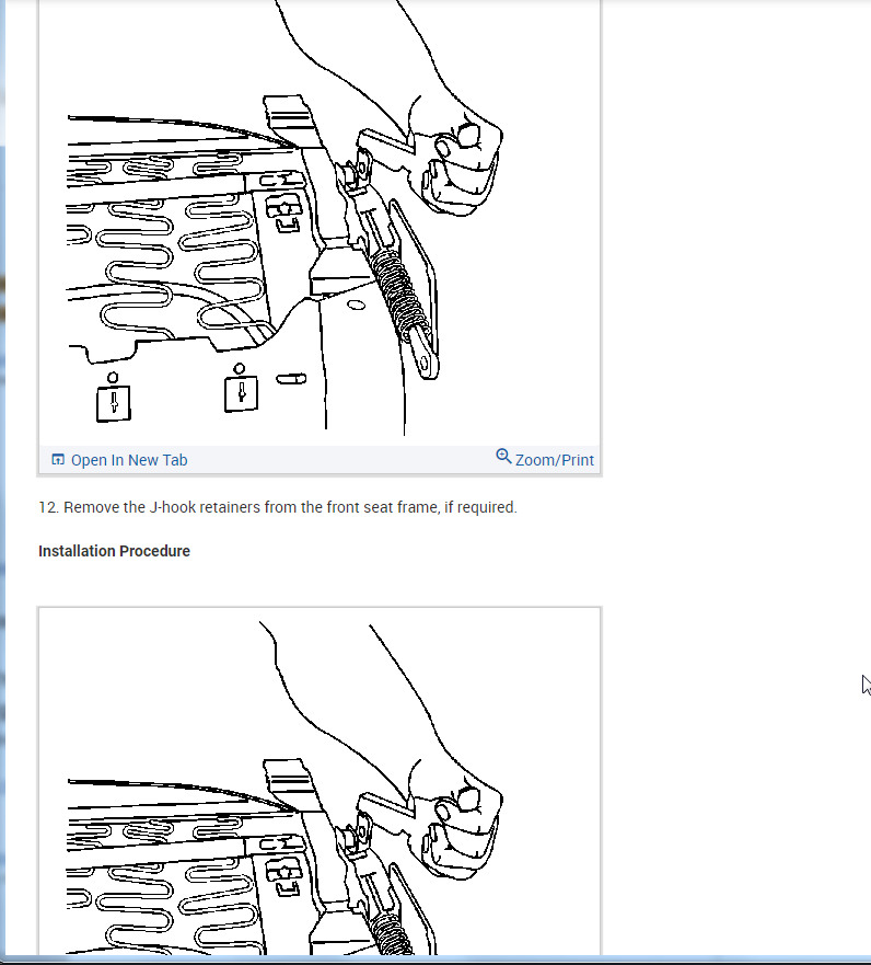

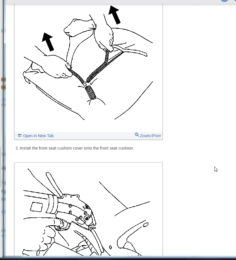

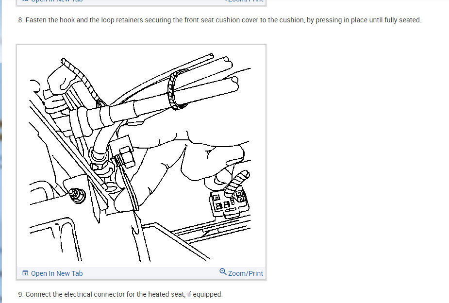

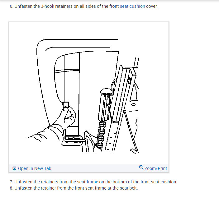

Unfortunately the only way you are going to replace them is the seat cover has to be replaced. There may be some interior shops that work on this stuff willing to take them out and sew in new ones but I figure most will just tell you to replace them.
I attached the process for this. Let me know if you have questions or need other info.
