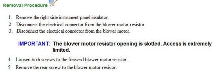

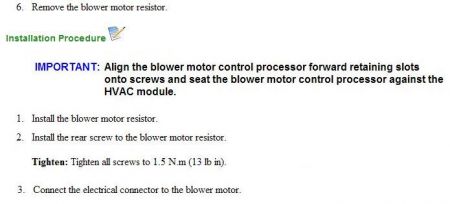

Where is the blower motor resistor located? How do I replace this part on my own?

https://images.2carpros.com/forum/automotive_pictures/261618_Noname_1162.jpg
https://images.2carpros.com/forum/automotive_pictures/261618_Noname2_337.jpg
https://images.2carpros.com/forum/automotive_pictures/261618_Noname3_126.jpg
