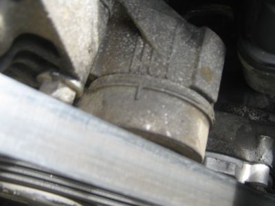

my engine is a 3.8
directly under the alternator there is a device which is i do not know what it is there are three lines on the top.
under this there is a rigid pipe coming ount of intake manifold. this pipe goes under the alternator
i saw liquid dripping out of there that may be prestone[img:52bc70ff93]http://www.2carpros.com/forum/automotive_pictures/553991_IMG_1226_1.jpg[/img:52bc70ff93]

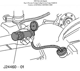

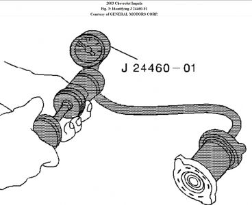

Thats a picture of the serpentine belt tensioner pulley, so the antifreeze is dripping onto that from possibly the water pump or radiator hose, Use a cooling system pressure tester attached to the radiator and pump it up to the pressure listed on the cap, usually 16 psi, any leak will become apparent real fast! Autozone has a tool loaner program if you don't have it. Then test the cap as shown below.
https://images.2carpros.com/forum/automotive_pictures/62217_Cooling_system_tester_1.jpg
https://images.2carpros.com/forum/automotive_pictures/62217_cap_test_1.jpg
