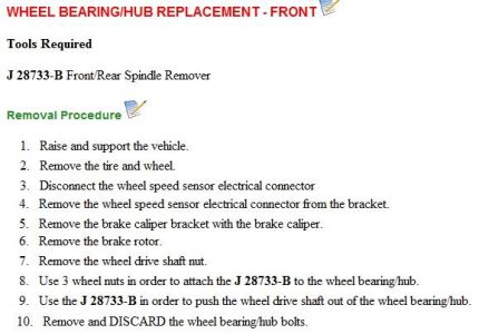

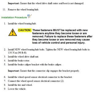

2002 Chevy Impala wheel hub replacement
2002 CHEVROLET IMPALA
CECIL D GRUBBS
Suspension problem
2002 Chevy Impala 6 cyl Front Wheel Drive Automatic
May 30, 2010 at 4:05 PM
BLUELIGHTNIN6
  • 16,542 POSTS
https://images.2carpros.com/forum/automotive_pictures/261618_Noname_2281.jpg
https://images.2carpros.com/forum/automotive_pictures/261618_Noname2_748.jpg
