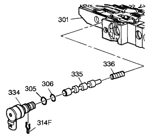

Where is the TCC solenoid located

Remove the case side cover. its #334

Were on the transmission is the tcc. At front back or sides

The torque converter clutch is built into the torque converter. That is what couples the engine to the transmission. The diagram above is just showing the valve that controls the clutch. The torque converter clutch can not be serviced or repaired. If there's a problem with it, which is very rare, the entire torque converter must be replaced. It is a sealed assembly. Replacing it requires the transmission to be removed. That is definitely not a do-it-yourselfer job.
