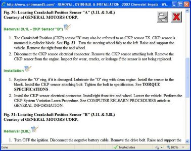

what has to be done?
May 24, 2010 at 4:09 AM
SATURNTECH9
  • 30,869 POSTS
https://images.2carpros.com/forum/automotive_pictures/416332_2002_chevy_impala_crank_shaft_postion_sensor_diagram_1.jpg
https://images.2carpros.com/forum/automotive_pictures/416332_2002_chevy_impala_crank_shaft_postion_sensor_replacement_part1_1.jpg
https://images.2carpros.com/forum/automotive_pictures/416332_2002_chevy_impala_crank_shaft_postion_sensor_replacement_part2_1.jpg
https://images.2carpros.com/forum/automotive_pictures/416332_2002_chevy_impala_crank_shaft_postion_sensor_replacement_part3_1.jpg
https://images.2carpros.com/forum/automotive_pictures/416332_2002_chevy_impala_crank_shaft_postion_sensor_replacement_part4_1.jpg

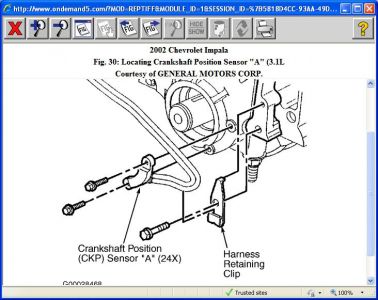

There's all the information you need for replacing the crank shaft sensor.
