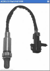

THanks. I will take a look. DO you have any pics that you can send?
Aug 22, 2009 at 12:57 PM
JDL
  • 16,098 POSTS
https://images.2carpros.com/forum/automotive_pictures/170934_02_impala_1.jpg
02 sensor.
