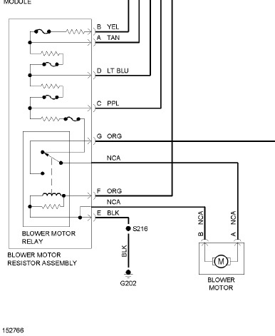

PETELOPEZ
I replaced the blower resistor,it was bad,still the blower did not work. I checked the wires on the harness to the resistor and no resistance between the wires coming from the selector switch. I don't know how to get to the switch without breaking something. I have checked all fuses related to the ac circuits.
Apr 17, 2008 at 7:16 AM
  • 55,224 POSTS
The blower motor goes out int hses cars and takes out the resistor. I would test the power at the blower motor and then if bad replace the blower. Here is a guide that will help you get the job done.

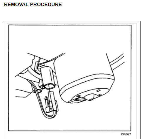

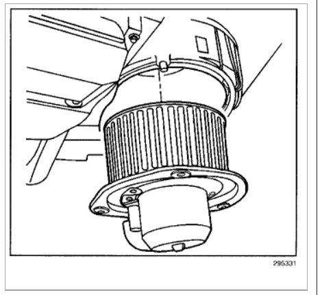

SCOTT4440_1
I have a 2000 Impala with 103,000 miles and I am experiancing my 1st problem with it . The blower for the air and defrost has stopped working and i cannot seem to locate it . Is there a way to access it so as to fix it myself ?
Dec 30, 2019 at 7:13 AM (Merged)
RHALL77
  • 3,361 POSTS
its under the dash on the passenger side. also check the resistor, it is right next to it.

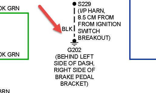

HMAC300
  • 48,601 POSTS
both of these ground in the same location see if it's loose and or corroded. see pic

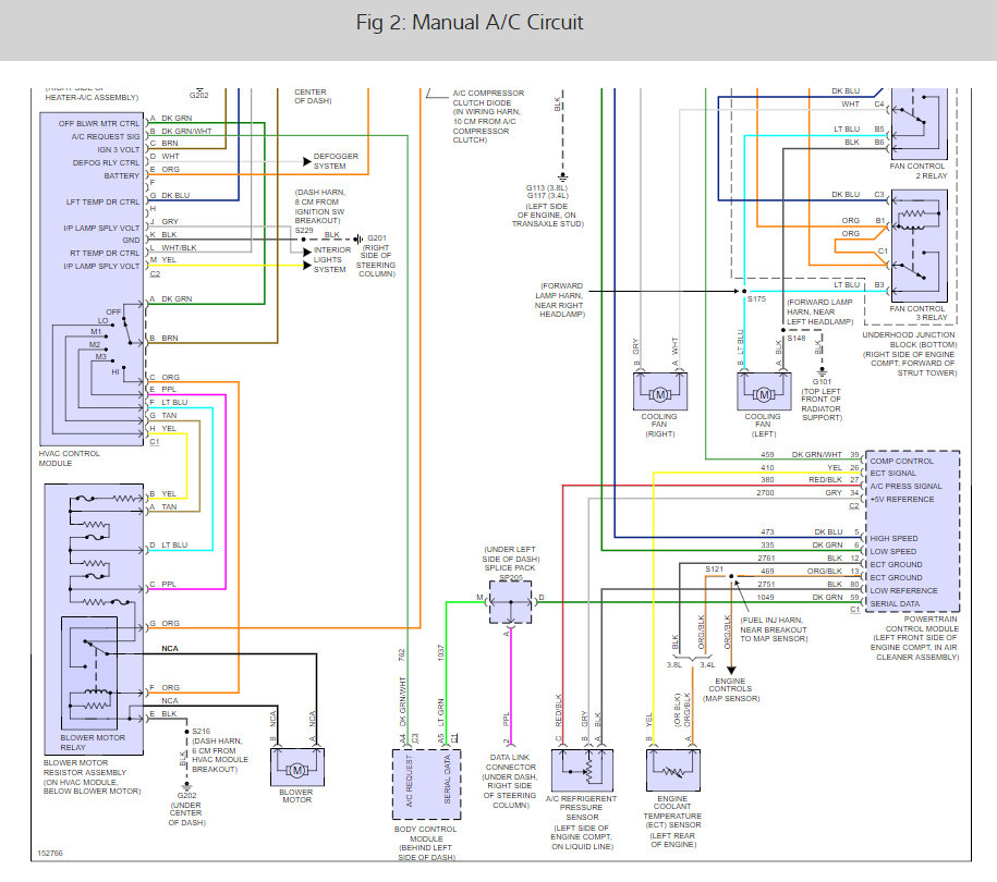

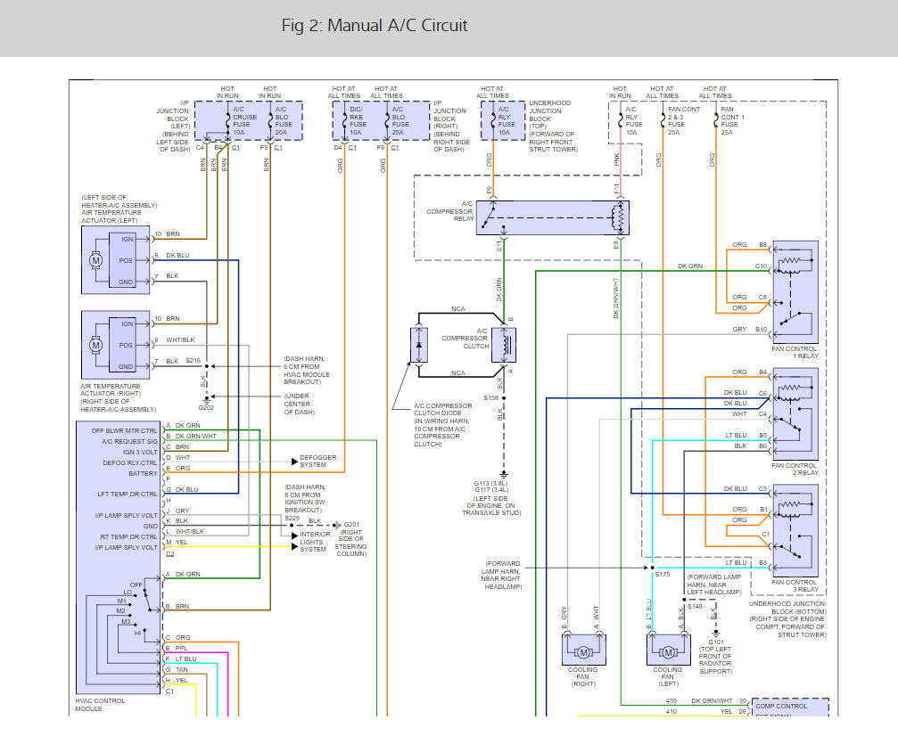

GJULIAN12
When I turn my heater on the fan no longer works. It used to not work on settings 1 & 2 and now none of the settings work (1-5) What could be the problem. I would prefer to fix it myself. If you could send a schematic or a picture that would help alot.
Jun 12, 2020 at 4:42 AM (Merged)
RENAUDTN
  • 636 POSTS
Hello there,
Your problem is probably a bad blower resistor.
Check the following link:
https://www.2carpros.com/forum/viewtopic.php?p=206376
Hope this help.
GJULIAN12
Ended up being the resistor and the blower motor. Had to replace both. Thanks everyone.
