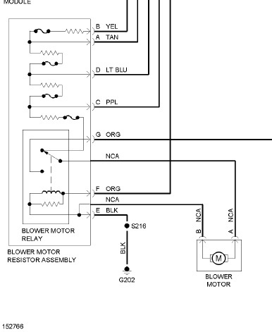

Blower motor for heater only operates on highest setting will not operate on lower settings, what gives?
Dec 30, 2019 at 3:10 PM (Merged)
JDL
  • 16,098 POSTS
Maybe a problem with blower resistor? That should be close to blower motor, under dash, passenger side. You may be able to get at it through glove box, if not then have to get at it from under dash. Also, check blower fuse, left side of dash, check the fuse and voltage, goes hot with the key on.

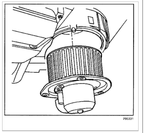

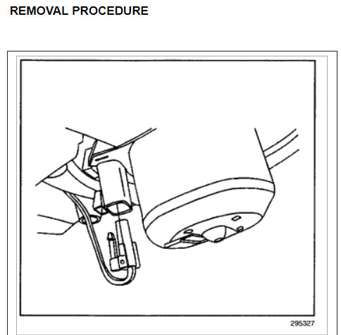

SCOTT4440_1
I have a 2000 Impala with 103,000 miles and I am experiancing my 1st problem with it . The blower for the air and defrost has stopped working and i cannot seem to locate it . Is there a way to access it so as to fix it myself ?
Dec 30, 2019 at 3:13 PM (Merged)
RHALL77
  • 3,361 POSTS
its under the dash on the passenger side. also check the resistor, it is right next to it.

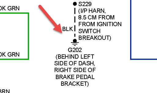

BAYRES
Our Impala blower and cruse control stops when hitting a bump is this a common problem?
What has worked to correct it?
HMAC300
  • 48,601 POSTS
both of these ground in the same location see if it's loose and or corroded. see pic

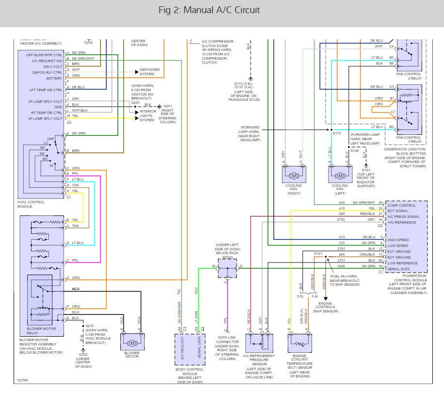

GJULIAN12
When I turn my heater on the fan no longer works. It used to not work on settings 1 & 2 and now none of the settings work (1-5) What could be the problem. I would prefer to fix it myself. If you could send a schematic or a picture that would help alot.
