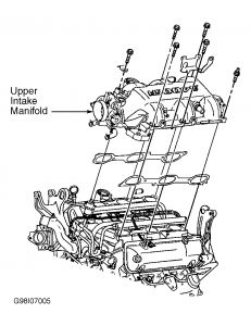

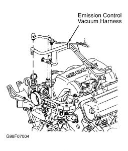

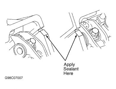

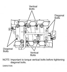

i put a new intake and plenum gasket on now the car has no power and sounds like its a squeaking almost like air u think i dident seal the intake right

This guide can helps us find the vacuum leak https://www.2carpros.com/articles/how-to-use-an-engine-vacuum-gauge
