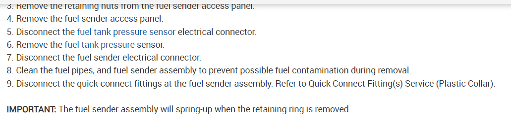

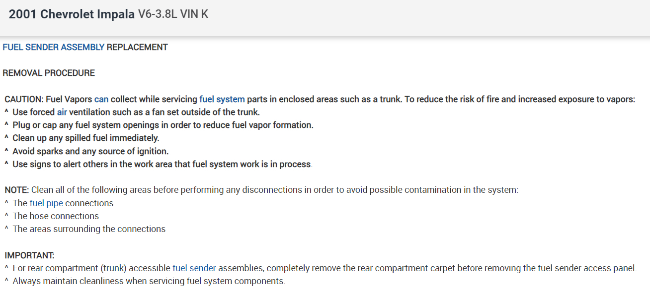

my gas gauge read full when i'm driving and then when i stop it read empty. i need to know how to fix it. i ran out of gas 4 times because i can't tell how much gas i have? i have a one year old and a wife that i don't want to see on the side of the road.
Dec 14, 2007 at 2:12 PM
DENNYP
  • 1,824 POSTS

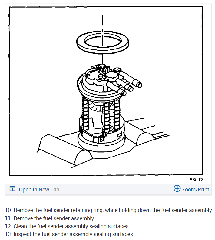

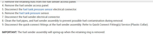

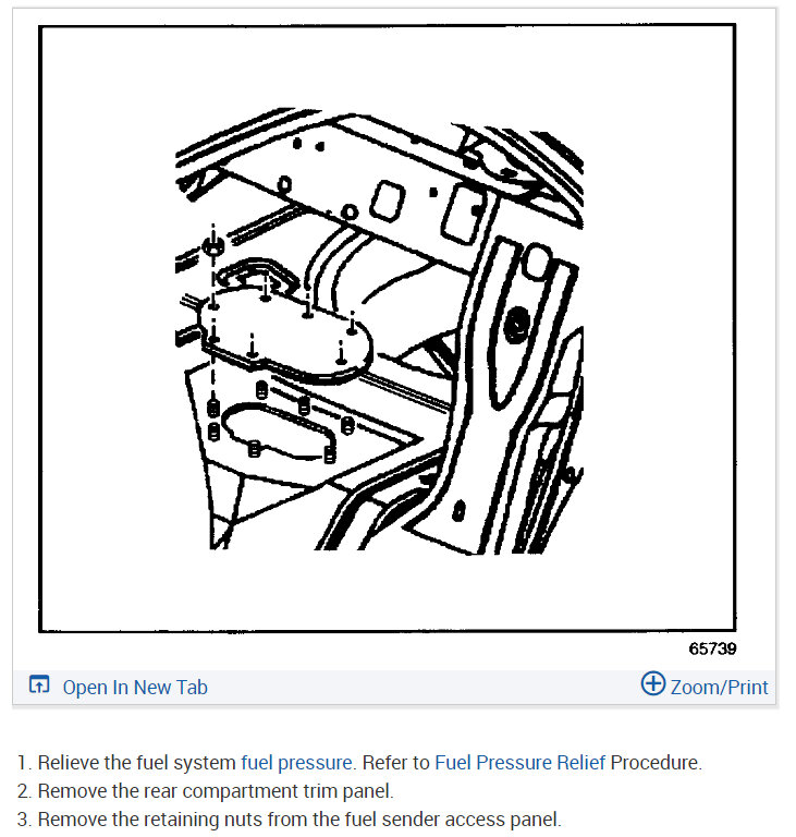

sounds like you probably have a bad fuel level sensor in the fuel tank.
Dec 18, 2007 at 12:35 PM
  • 55,628 POSTS
I agree with DENNYP, 9 times out of 10 it will be the fuel level sender hee is how to replace it, I would get a new fuel pump as well because it comes as part of the sender. Luckily the car has a trap door so change the pump and fuel level sender is easy.
