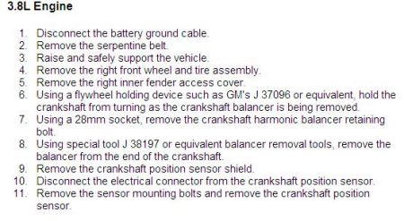

i need to know how to change a crankshaft sensor if possible can u send pics with the answer?

Welcome to the forum, I'm not sure of engine litre size? I looked at the 3.8L engine. I didn't notice a picture.
https://images.2carpros.com/forum/automotive_pictures/170934_impala_crank_sensor_1.jpg
