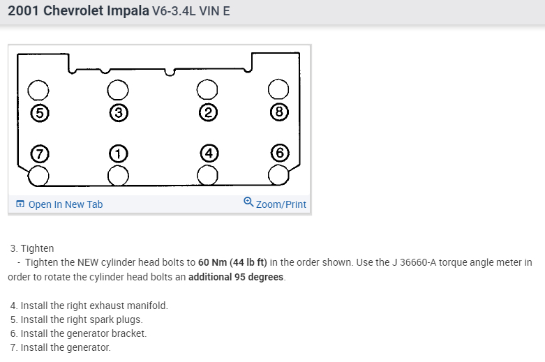

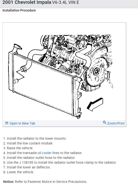

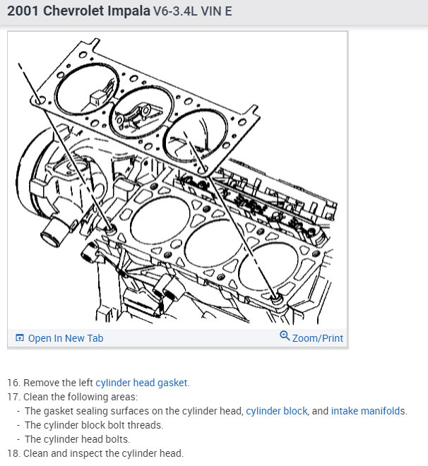

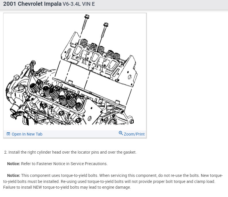

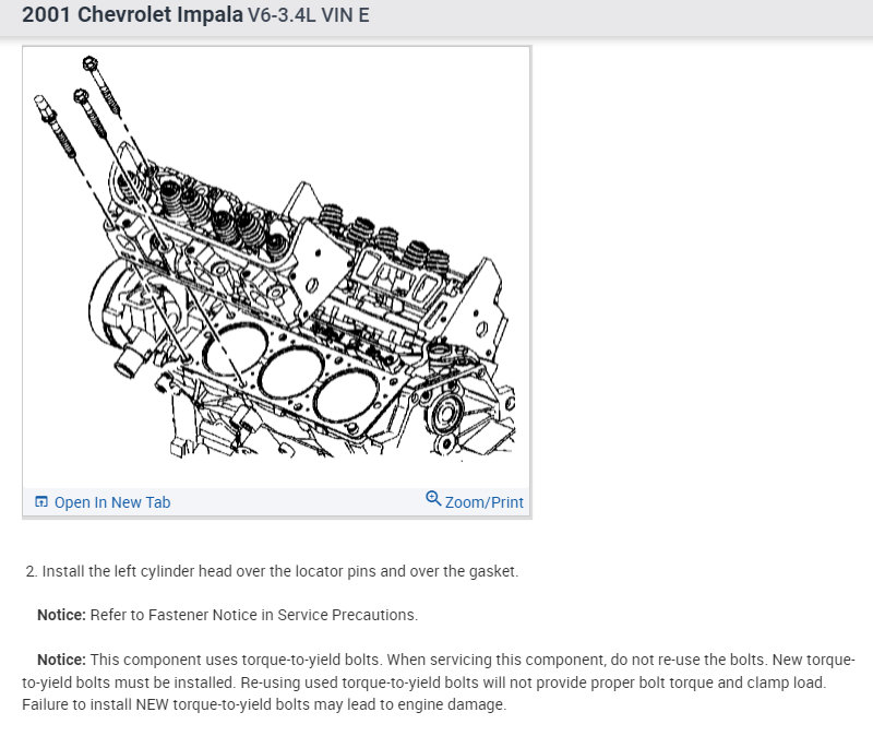

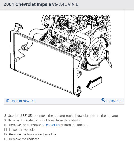

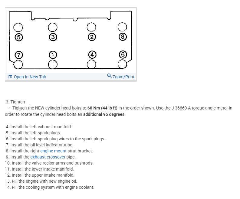

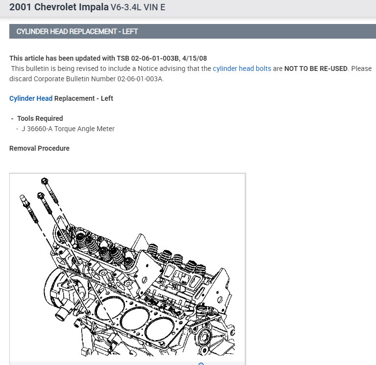

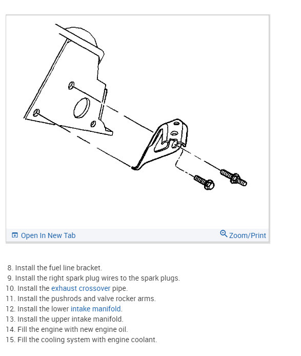

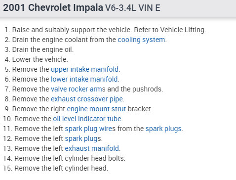

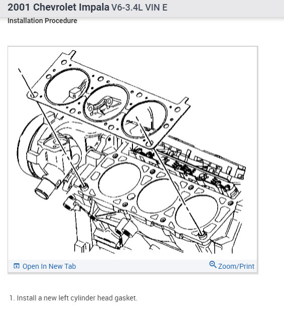

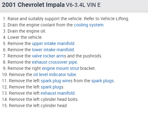

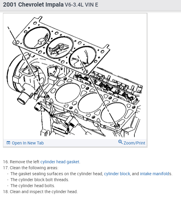

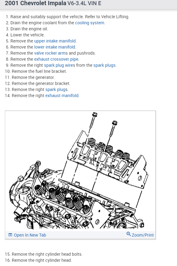

I have attached the replacement procedure below as a reference.
