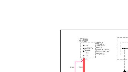

my 2001 impala had some high water damage. The starter was broke, I replaced the starter, and now the starter turns but dont engage the flywheel. Starter bench checks o.k.

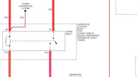

Check the ABS/PCM fuse 10amp and crank relay then get back

All fuses and relays ok, still nothing. Please help I will pay more if you can help fiqure this out

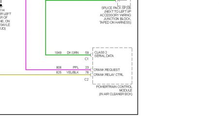

Test the fusible link blue 18 gauge that's coming from the remote battery stud. This checked out its gonna come down between the ignition switch and computer. Hold key at start position and check computer control of relay purple wire whether it has power see below

Test the purple wire for power going to the computer see above circuit
The computer is in the aircleaner box
