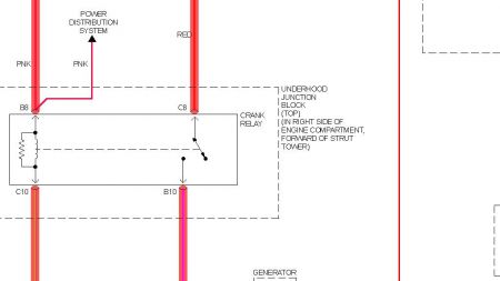

  • 75,988 POSTS
Check the ABS/PCM fuse 10amp and crank relay then get back
https://images.2carpros.com/forum/automotive_pictures/12900_abspcm_1.jpg
https://images.2carpros.com/forum/automotive_pictures/12900_crank_relay_1.jpg

All fuses and relays ok, still nothing. Please help I will pay more if you can help fiqure this out

Test the fusible link blue 18 gauge that's coming from the remote battery stud. This checked out its gonna come down between the ignition switch and computer. Hold key at start position and check computer control of relay purple wire whether it has power see below
https://images.2carpros.com/forum/automotive_pictures/12900_computer_1.jpg

fusible link ok
Aug 4, 2008 at 7:35 AM
  • 75,988 POSTS
Test the purple wire for power going to the computer see above circuit
The computer is in the aircleaner box
