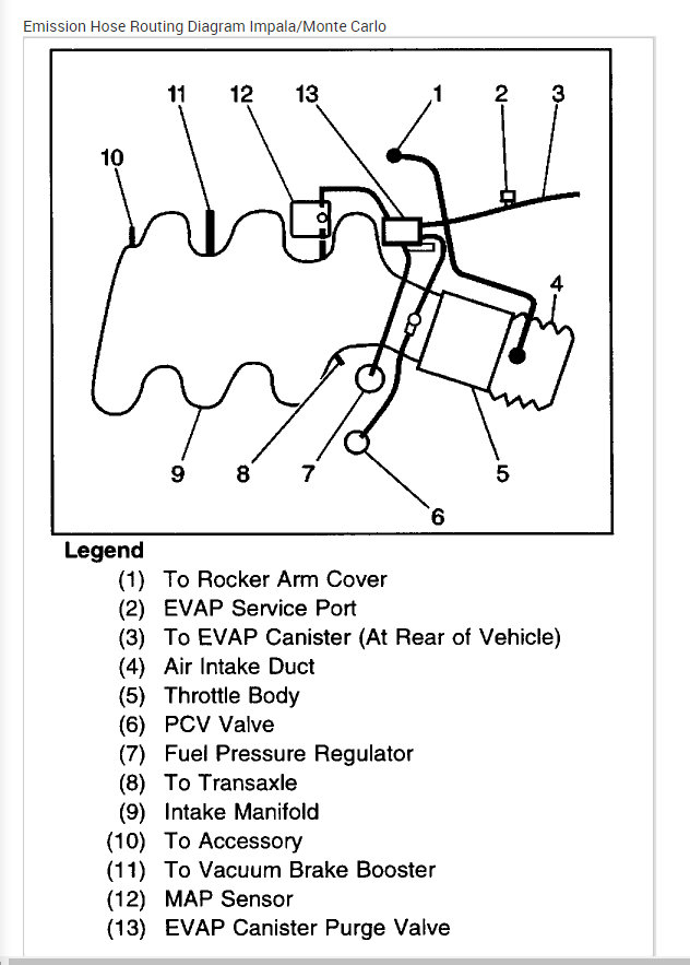

All I would like, is if I could view a vacuum diagram for the 2000 Chevy Impala, 3.4ltr. Why has this become so difficult! The world is hard as it is, and now people want to suck the last ounce? Will you help me with my search?
Oct 26, 2009 at 2:12 PM
I will attach the diagram below that will help with layout of the vacuum system.
However, if you have a vacuum leak, this guide will show the easiest way to find it and correct it:
Please run through this and take a look at the routing below and let us know if you have other questions. Thanks
