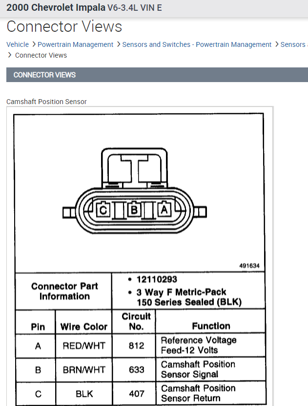

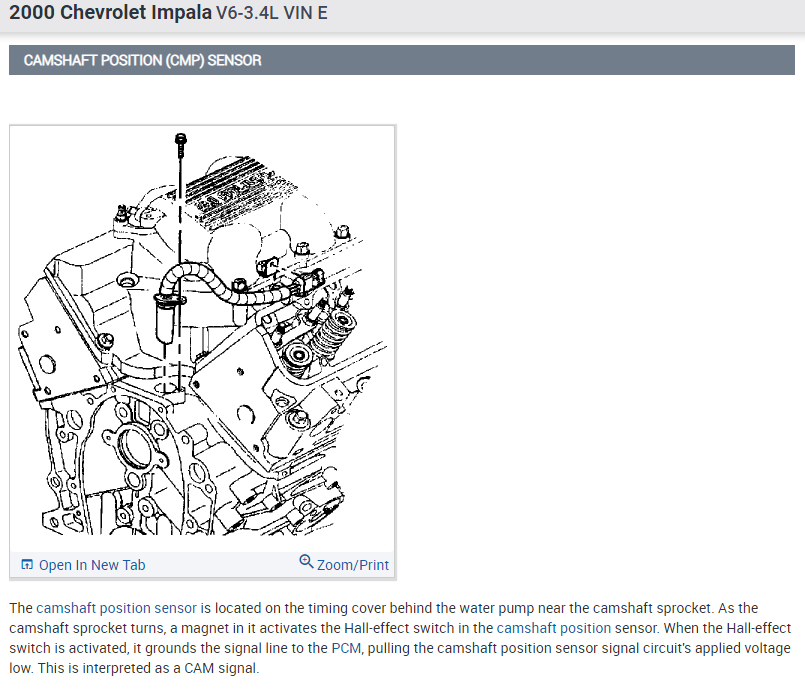

Where is this location of cam shaft sensor location?
Sunday, September 5th, 2010 AT 3:59 PM
SQM
  • 6,383 POSTS

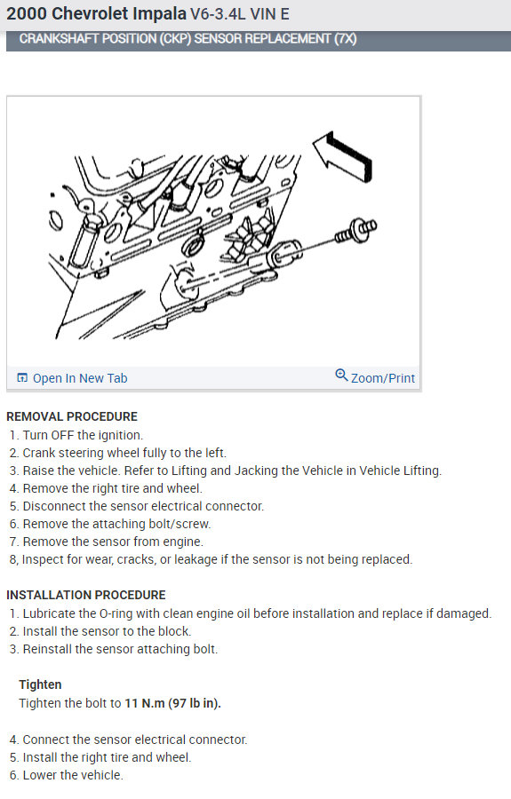

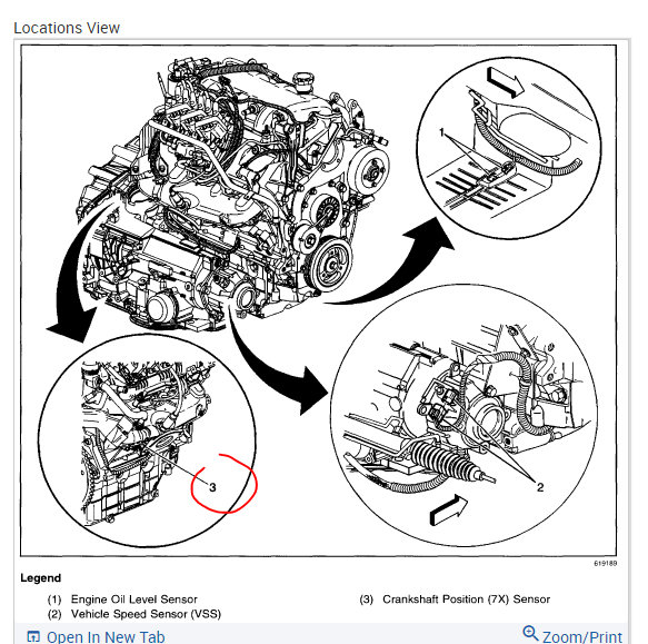

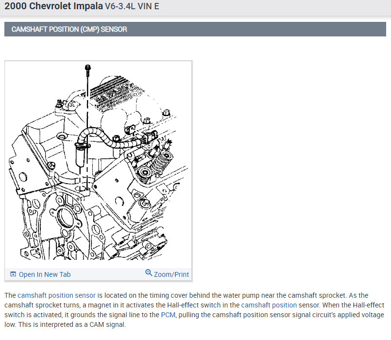

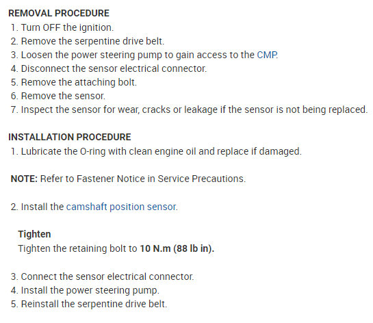

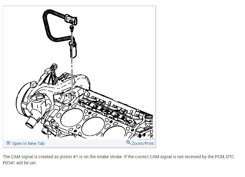

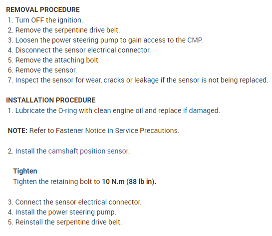

The camshaft position sensor is located on the right side of the engine, below the intake plenum. (see diagram) It is mounted by a single bolt.
The crankshaft position sensor is located on the lower part of the engine close to the crank pulley (see diagram). It is also mounted by a single bolt.
