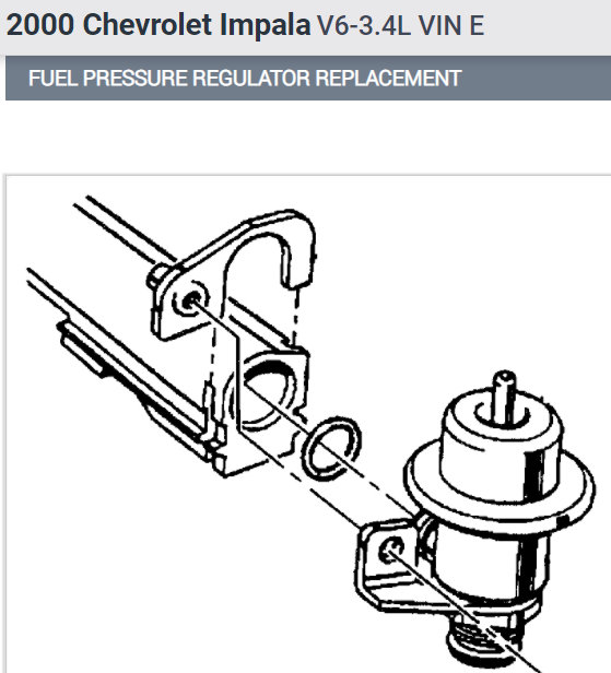

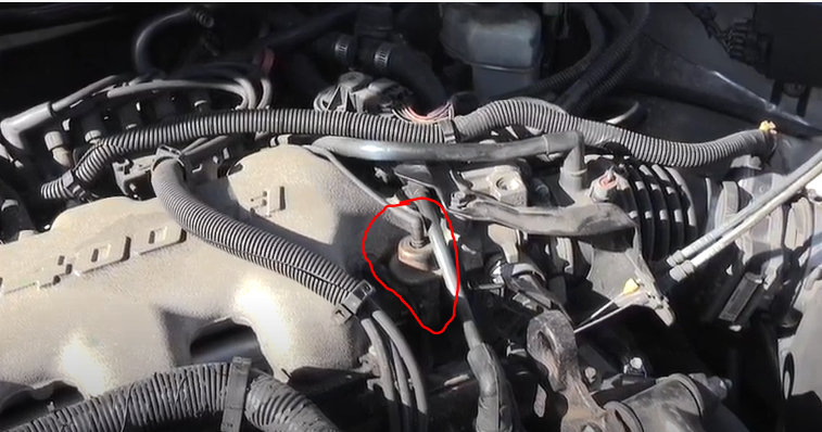

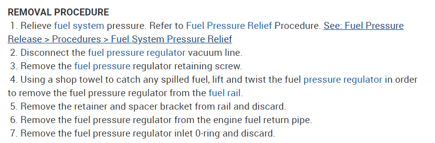

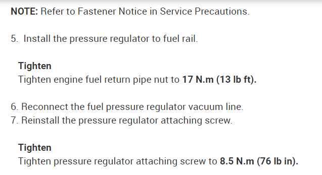

A few questions: While holding the throttle down about halfway, should I be getting a consistent "pulsing" revving of the engine? Might that indicate a faulty fuel pressure regulator? Where is it located on this vehicle (it has the 3.4 v6)? Finally, how difficult to replace if needed? Thanks for any assistance...
Jun 28, 2010 at 9:00 AM
DANNY L
  • 5,648 POSTS
Hello, I'm Danny.

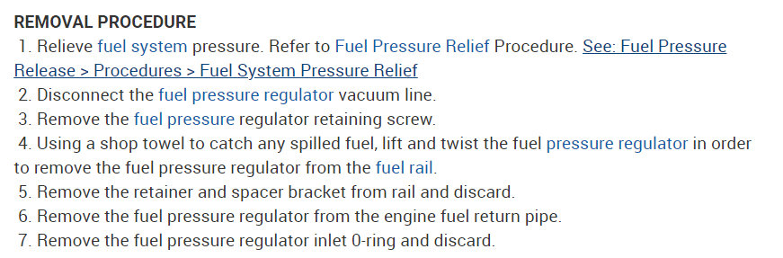

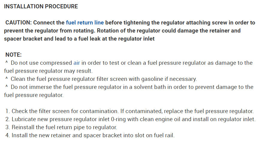

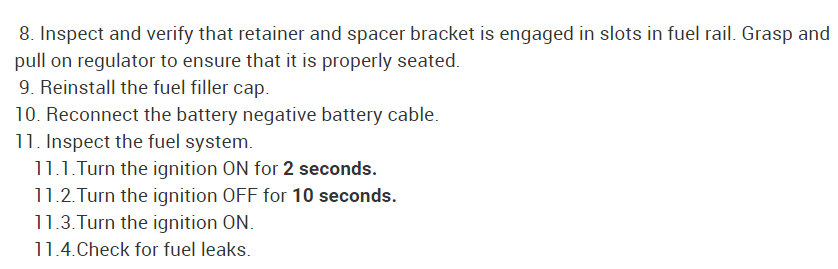

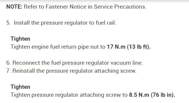

I've attached picture replacement steps below for you fuel pressure regulator on your car. I've also attached a picture below of its location and circled it in red. Hope this helps and thanks for using 2CarPros.
