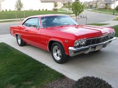

I have a new rebuilt 408,60 over 396 engine--new bearings-pistons-head work-new cam(magnum 280 comp cam)---no problem with performance---runs very well!!---however I don't understand why it runs so well @ 30 deg. at idle and 47 total at 3200 rpm's---(no ping etc.)--I just dont know what I did to make the inital timing run so high in order to run very well???---its driving me crazy--I am 67 year old gear head and can't figure it out--HELP---Tim Fritchen

All I can think of is the comp cam...usual timing for 396 is 4 degrees! 30 is the dwell...U didnt measure that did you?

I use a high energy gnition with 50000 volts--at 4 deg. advance it won't even idle!---as long as the engine is running good I won't take it apart--I had 11 to 1 pistons and changed to 9 1/2 compression for a better driver and went from a 305 to a 280 cam. thanks for your response--Tim

Tim don't forget, just because the factory spec is 4 degrees, it's an average of 10 motors and where they run best...can be different! I used to advance until it pings, then back off a bit..optimal!
Sweet ride!
