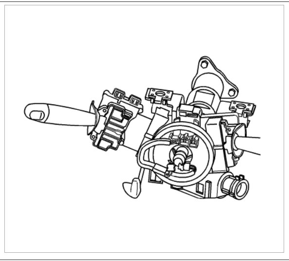

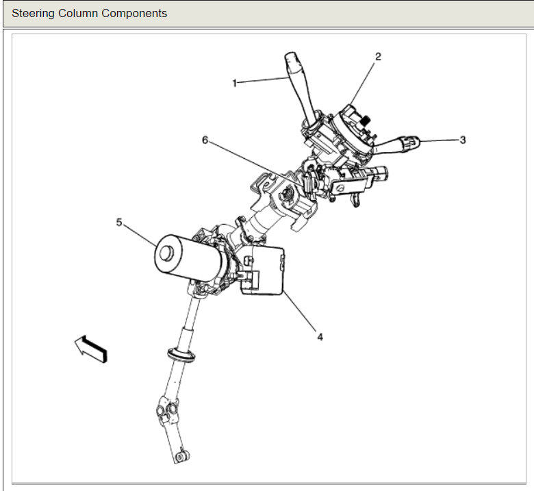

Turn signals do not cancel after turn
Apr 11, 2010 at 1:01 AM
GMTECH
  • 537 POSTS
If your turn signals do not cancel after a turn then you will need a new turn signal switch in most cases. The contacts that push out the cancel tab are weak but also check the internal tab that contacts the cancel of the switch.
Here are diagrams to help you see what you are in for when doing the job.
