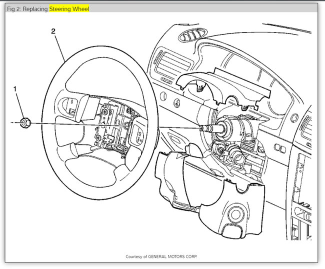

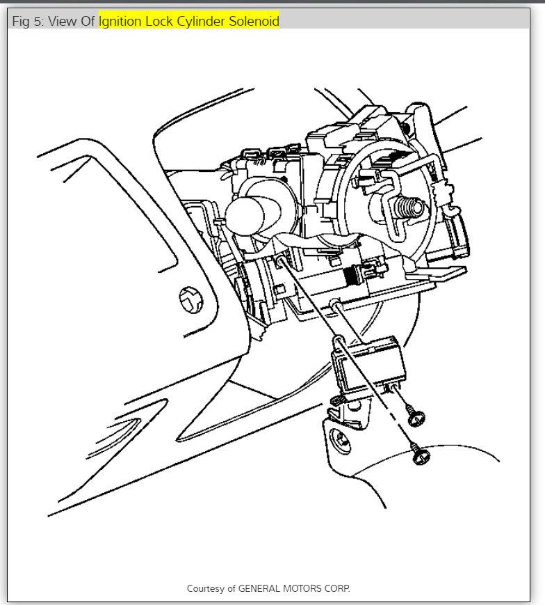

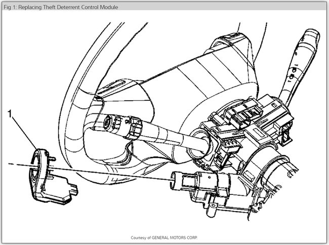

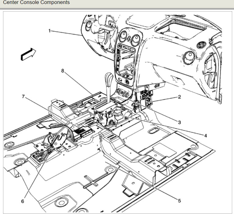

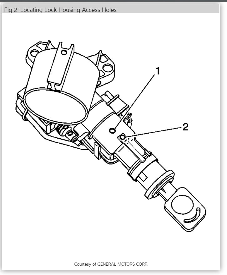

Goes into park but steering wheel does not lock. Shift button does not pop out and keys will not come out key also stays in accessory?
Jul 20, 2010 at 6:22 PM
GMTECH
  • 537 POSTS

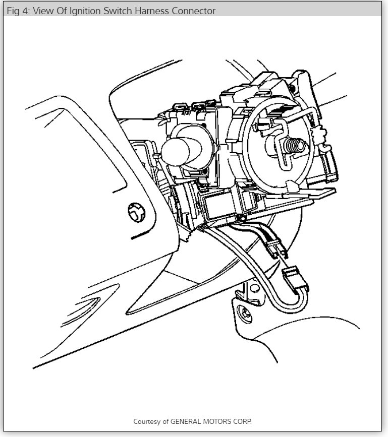

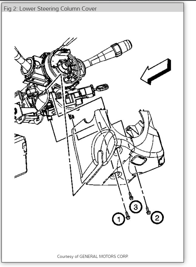

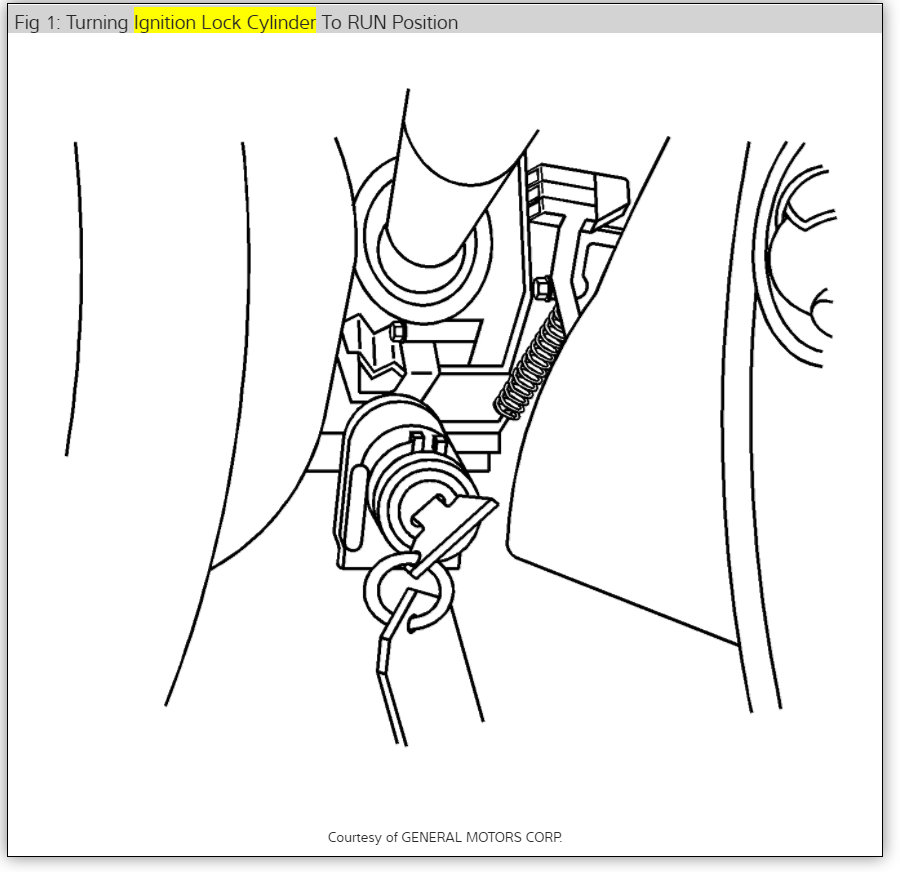

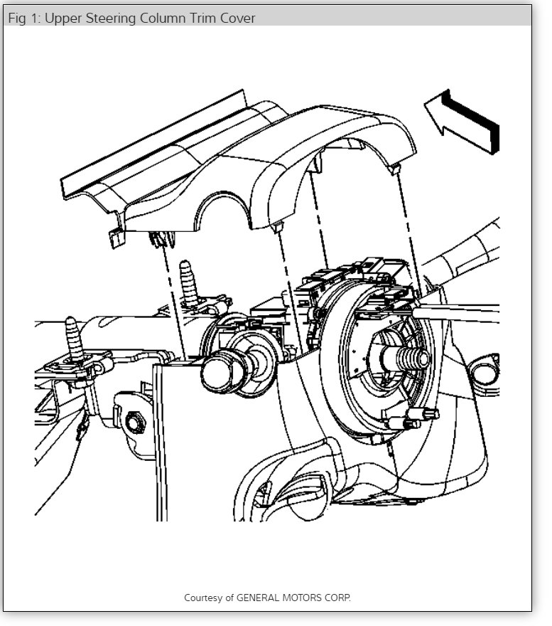

There is a shift lock cable that goes to the gear selector if that is okay the ignition switch tumbler sounds like it went out which is common here are diagrams to help you get the problem fixed.
Cheers
Oct 30, 2010 at 2:31 AM
SSHEETS02
Thanks for the diagrams it turned out the ignition witch was bad. Great site btw
