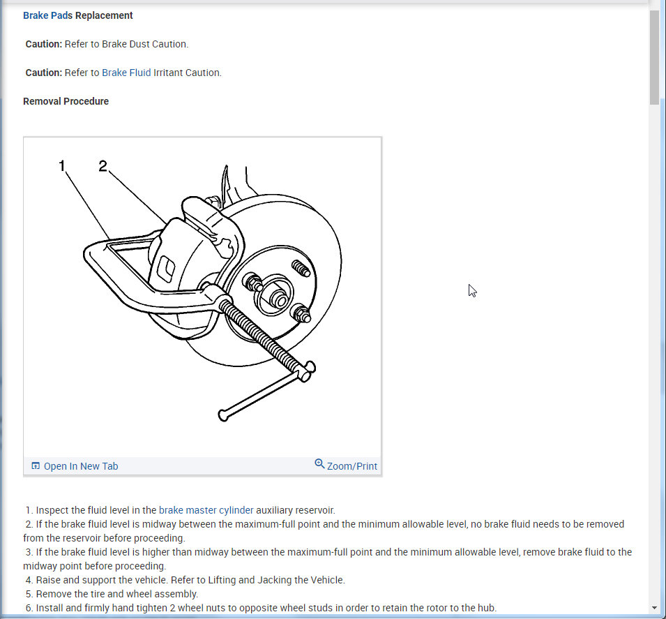

My brake warning light is on I need new front brakes please help.
Oct 7, 2010 at 4:33 AM

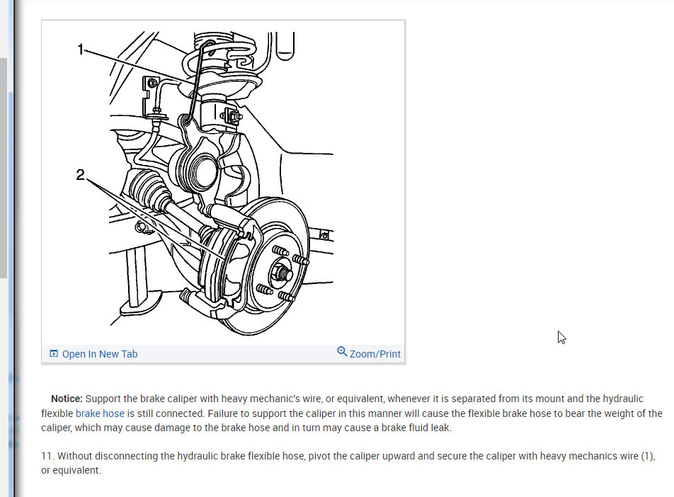

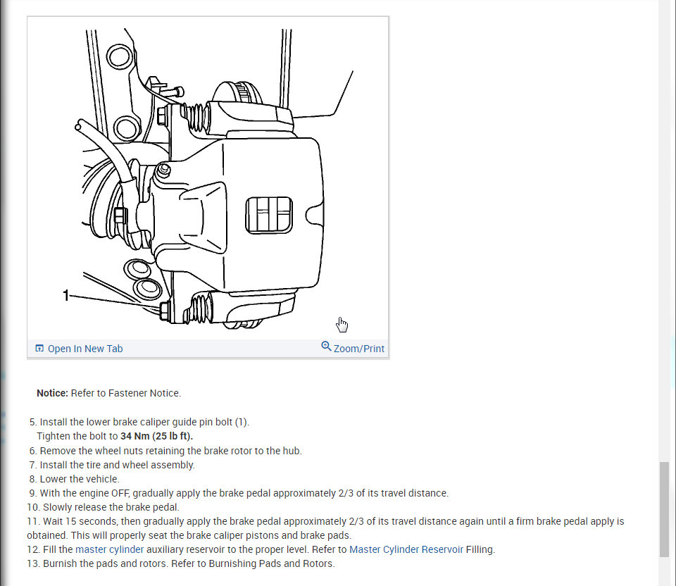

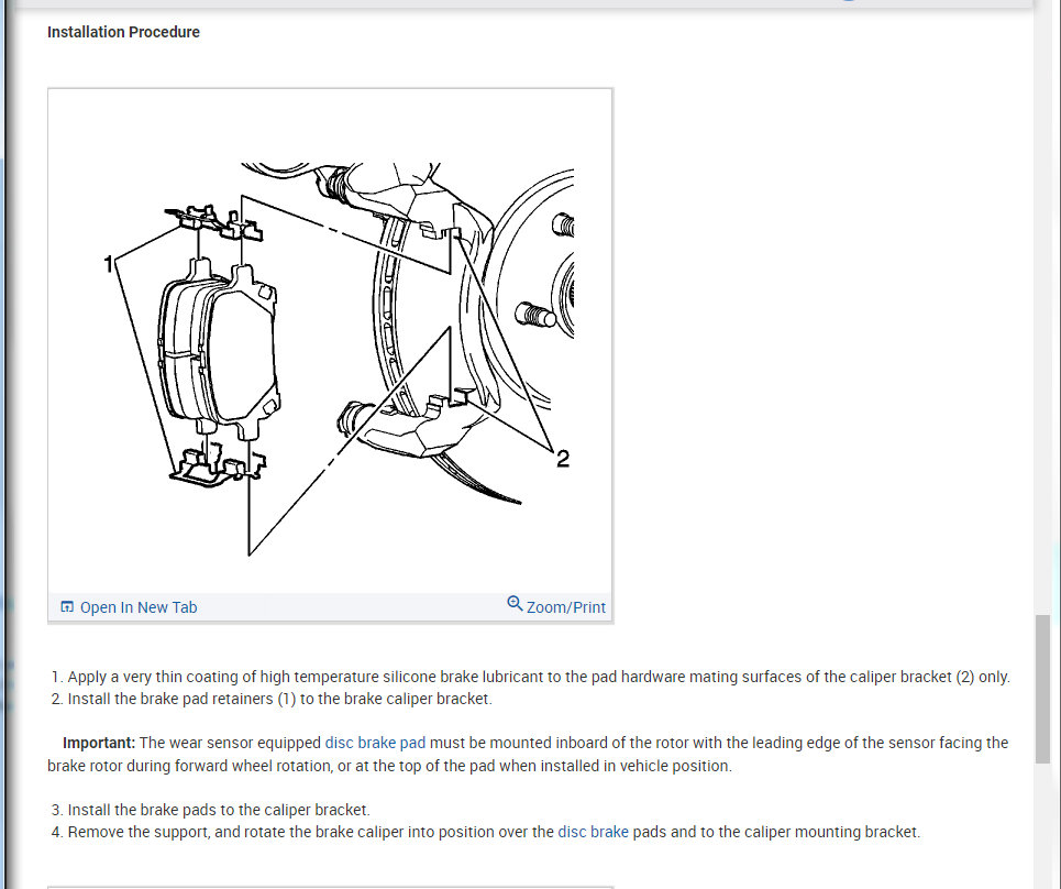

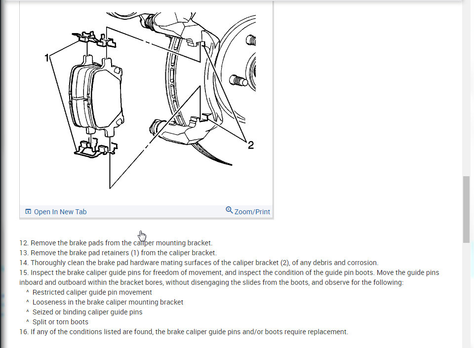

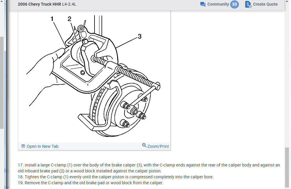

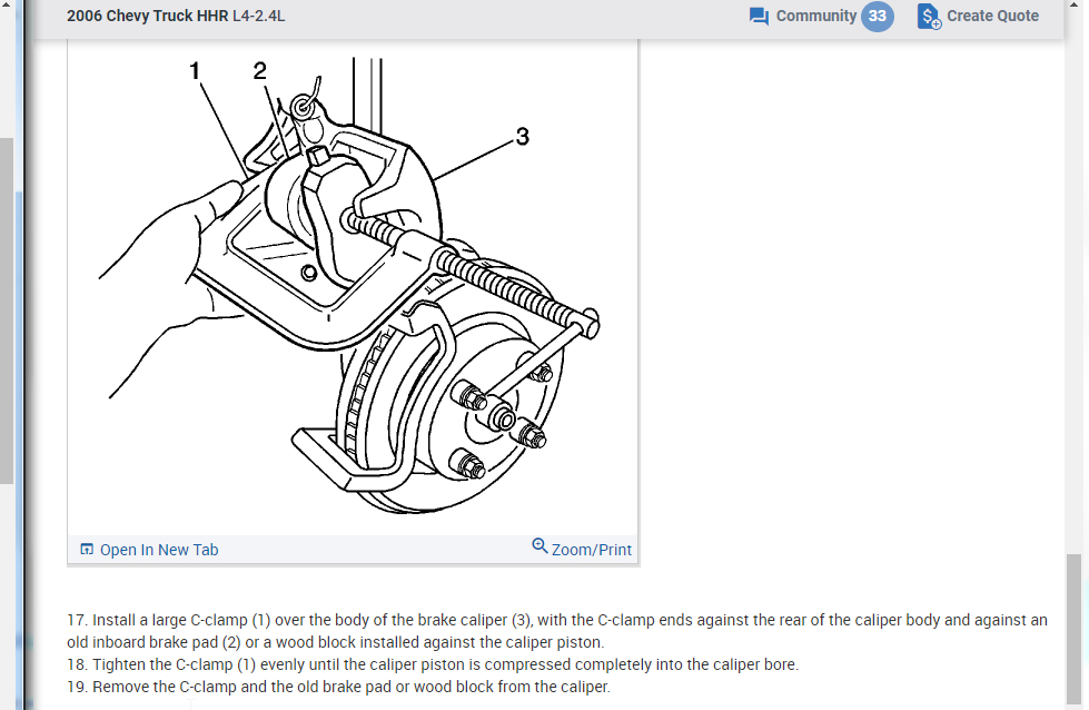

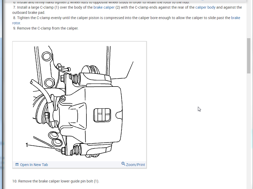

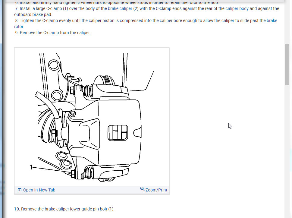

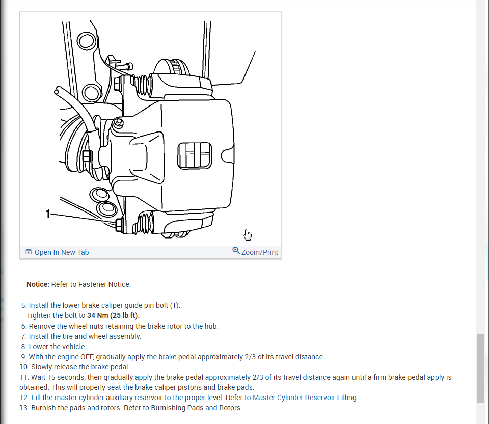

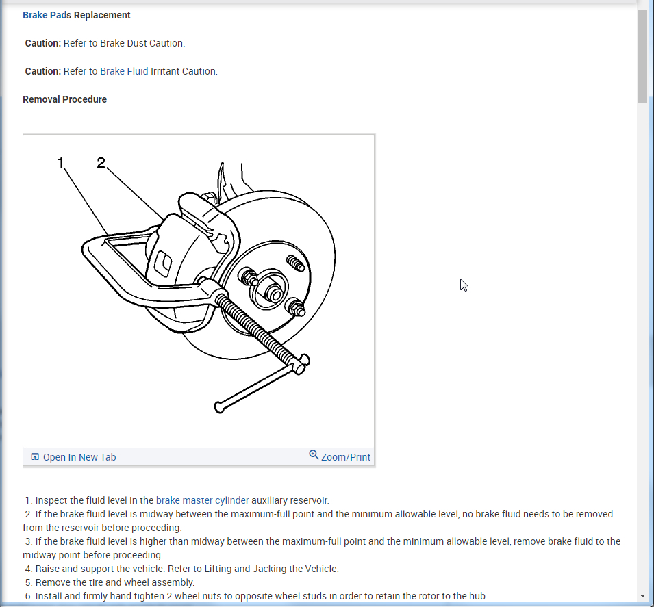

Here are guides that will help with this however, you said in the subject that you wanted rear brakes but in the post you asked for the front. I suspect you need the front so here is a guide that will help with this:
Below is the process from the manual on this. Please run through this material and let us know what other info you need. Thanks
